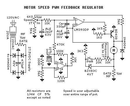

I have a 27.5 vdc circuit that will control a 18v motor and keep it at a constant speed when different loads are applyed to the motor
problen is one of the caps are labeled as fallows
10 percent,MF,1.0nF,NI. the 10 percent I get,the metal film i get,1.0 nF get that too. what i don't get is the NI. does NI mean niobiun oxide, if so are these caps metal film.
thanks to anyone who can help

It could mean non inductive. It's difficult to help to read a diagram that we cannot see.
I'm with KI6RWX, Non Inductive. The circuit that it is in is a saw-tooth oscillator which generates a puesdo-triangle wave which is compared to the a slowly-varying voltage level proportional to the motor's speed to produce the pulse-width modulation which switches the motor on-off.

so what type of cap is it? can I use any metal film cap or what? or is non inductive a specific type
Any non-electrolytic capacitor (film or ceramic) should work.
