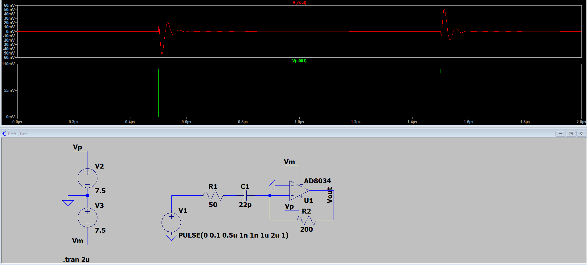

The response with and without AD8034 in the circuit :
You have a differentiator response with or without the AD8034, the passive
approach limited, as is 8034 with its limited slew and GBW.
You would have to examine 8034 spice model to see if there is any parasitic
path from input to output, to see if it contributes outside its GBW.
Hello Danadack, So with the opamp its just some sort of high pass filter weaker responce.
A pulse of 1n is 350MHz fundamental which is being passed threw, and we want to pass it threw as best as possible.
Two questions:
1.How do I know that the slew rate of the opamp is not enough for good differtiation?
2.How Can I know given the pulse the needed BW of the OPAMP?

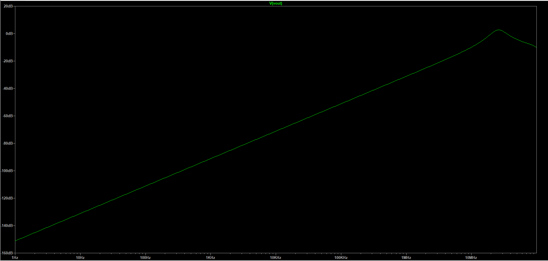

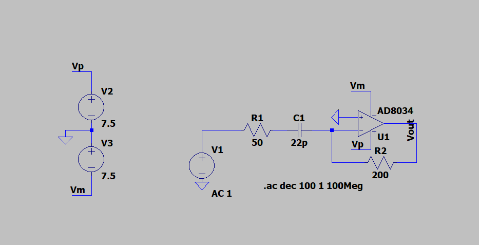

Hello , I have done an AC responce of the differentiator and as you can see the BW is very high.
differentiator is a high pass filter and we get the passband 25MHz and going up.
There is the RC connection of the circuit and the OPAMP itself.
How can I know given the AC responce that the OPAMP BW is not enough?
Thanks.

When you see the OpAmp lose its grip on its virtual ground then
it increasingly is no longer a factor is one way of evaluating it.
But remember small signal bode plots do not take into account
slew rate, so both have a play in transfer function performance of
the circuit. Slew rate is a non linear effect, essentially your amplifier
no longer responds in a linear fashion when its spec limits are reached.
