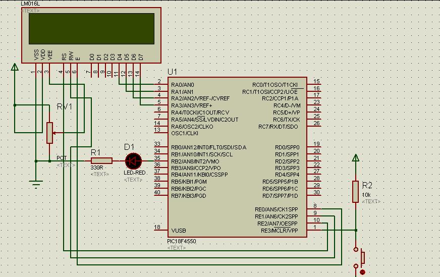

Problem using LCD on PortA and PortE with MiKroC
Nizar
Every thing works OK when I'm using Proteus with but in the reality when I make my circuit nothing appears on the LCD I'm using PIC18F4550 und LMB162A LCD my Cristal is 8MHZ
I think the problem is by using PortA or PortE when I use PortB or PortD every thing is OK.
Thank You all
This is my Code:

This is my circuit:

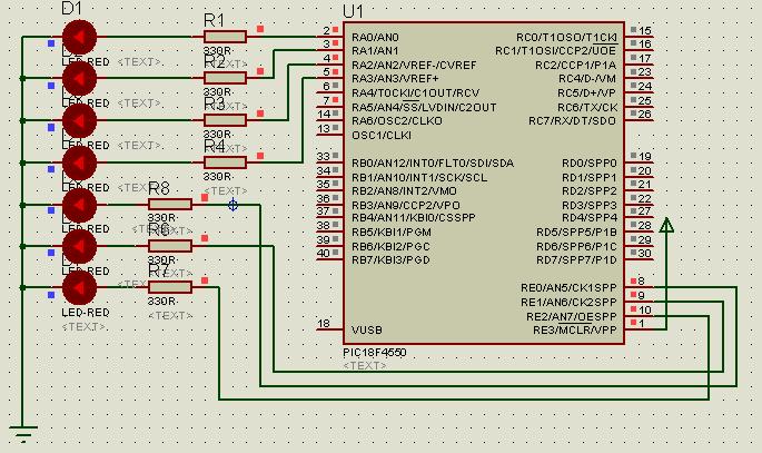

Sorry It doesn't work
I put putt-up res. but I get nothing.
So, when do LED test on PortA and PortE (without putt-up res.)I get sometning unblieveable: LEDs RA0 and RA1 blink but RA2 and RA3 light without blinking.
On PortE, I get RE0 and RE1 blinked but RE2 does nothing.
But the programm works good on Proteus
This is the Code:

Circuit on Proteus:
Try changing all your port reads to latch reads,
so
PORTA = ~PORTA;
becomes
LATA = ~LATA;
Thank You all
:D
I got it due to Your help:
The Problem is that I used PORT instead of LAT
So, thanks for your help special Pommie.
