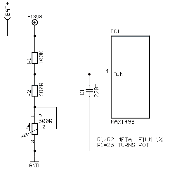

I have built a voltmeter for my car after some battery problems and used a MAX1496 IC which the datasheet has Voltmeter as one of its applications.
My problem is that I cant seem to get the voltage within range of the analog input of the IC. I have a 10k resistor from -Ain(which is grounded) to +Ain and a 1m resistor from +Ain to my cars + supply. The display goes overrange as soon as the supply is connected !
I have the Range pin grounded as in the Sheet for 0 to 2v as opposed to pulled high for the 200mV range and I am still getting no joy.
Could anyone look over the sheet for me and advise on how I should be connecting the supply to +Ain please. I have attached the sheet below.

Are you using the internal reference? If so, do you have intref (pin 9) connected to VDD?
Hi scorpio,
may be you used a wrongly dimensioned voltage divider.
Connect the suggested divider as shown in the attachment. A bypass capacitor of at least 100nF should be connected to AIN+. Using 220nF won't hurt. Place the cap as closely as possible to pin4 and ground. Connect AIN- to ground.
The divider (if set correctly) divides the input voltage by the factor of 100.
So at a battery voltage of 13.8V the output is 138mV (measuring range of the chip ±199.9mV), and should give you a direct readout of the battery voltage.

Hi Boncuk,
Thanks for the drawing I will try it now.
I will have to use a standard pot until I can get a 25 turn 500r, but I'm guessing that only the accuracy will suffer a bit for now.
All the best..........Al

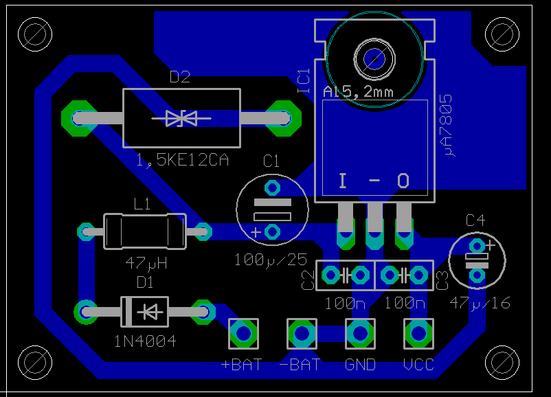

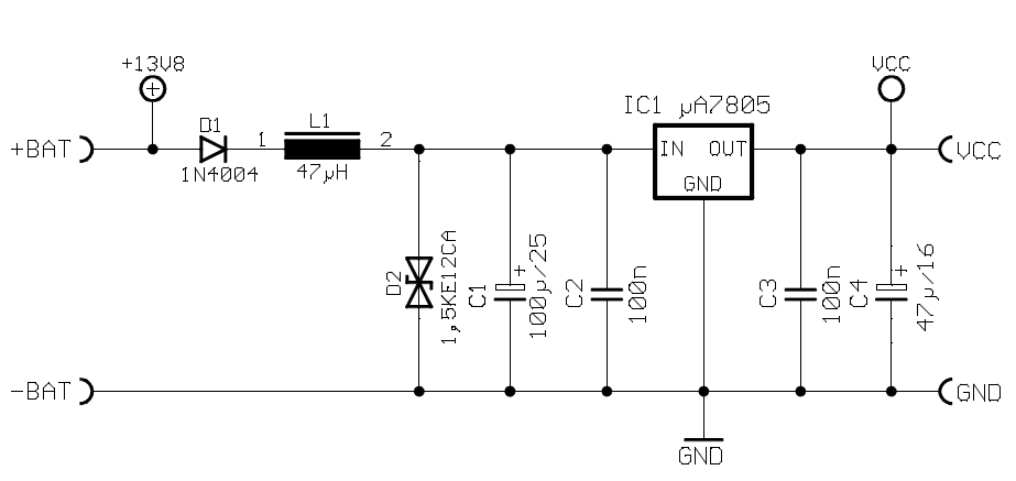

If the circuit works on the workbench don't forget to filter the car supply voltage well to protect the chip from spikes caused by the alternator.
Select a suitable transil-diode, e.g. 1,5KE12CA.
Datasheet attached.
Regards
Boncuk

If you have full-scale set to ±2V, why don't you divide your input by 10 instead of 100?
Hi guys,
Ron, I was looking at the wrong pin, 9 is to vdd its 10 that is grounded.
Boncuk, your divider works fine and I even found a 1k 25 turn pot to use!
Anyway thanks to you guys I have it working, although there must be something iffy somewhere still as I had to as suggested use 10k instead of 100k in the divider because I cannot use the 2v scale. For some strange reason connecting pin 10 to vdd shorts out the circuit entirely so I left that as Gnd and changed the 100 to 1 to a 10 to 1 divider.
But as they say, don't mend what isn't broken so I'm happy enough! Though I would like to know if anyone else builds something with this IC if they can put Vdd to pin 10?

Hi Scorpio,
I assumed you wire the chip for a range of 199.9mV. Connecting pin10 to VCC the range is like that. (connected to ground the range is 1.999V).
My suggested voltage divider was designed for a range of 199.9mV.
The transil-diode you should use is bidirectional type as indicated by the letter C in the value describtion (1,5KE12CA.
Here is a power supply circuit which works well supplying an MCU in a motorbyce.
D1 does not only reduce the power dissipation of the voltage regulator, but also serves as false polarity protection.
Board dimensions are: 1.800X1.325".
Boncuk
P.S. Using a large piece of copper (as washer) on the solder side of the board the mounting screw will conduct heat from the voltage regulator to the cooling surface.
