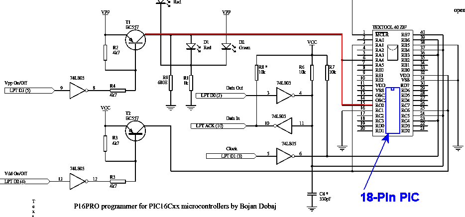

I'm almost all the way through writing my first program to the PIC. It's nigel's blinking LEDs program. I'm having some trouble though: I get this message when I load the .hex file with winpicprog:
Program verify failed at Program address 0x000, programming aborted!
When I build the file on MPLAB, it builds just fine.

The error has nothing to do with MPLAB but the hardware programming setup.
Check 16F628A pin 10 "RB4/PGM" pin. This pin should be pull down to 0V during programming.
This is by far the most common fault report I get, this error message usually means the PIC isn't being switched to programming mode. This can obviously be caused by a fault or mistake in the programmer, but is almost always caused by too low a supply voltage. To switch a PIC to programming mode requires slightly more than 12 volts on the MCLR pin, often 'wall warts' don't supply a stable clean voltage and fall short of this under load.
To check, select 'Hardware' from the 'Options' menu, then turn Vpp 'On' and measure the voltage on the actual MCLR pin (on some programmers you may need to turn 'Vdd' on as well).
This makes absolutely no sense to me! the MCLR pin is pin 1 on the schematic, but the schematic tells me to put an 18 pin IC with pin 9 on pin 20 on the programmer, so that pin 1 on my pic is lined up with pin 12 on the programmer. In other words, pin 1 on the IC and pin 1 on the programmer aren't lining up.
Something doesn't add up :lol:
Yes. The position is correct.
MCLR pin of the 16F628X PIC is on its pin4, not pin 1.
If you place the PIC with its 9th pin in the 20th pin of the 40-pin socket, the PIC's MCLR will then be located on the 15th pin of the 40-pin large socket.
Look back at the schematic of P16Pro40, pin 15 of the large socket is Vpp controlled by transistor T1 via Vpp On/Off signal.

Why does everything have to be so difficult!? I'm still getting the same error.
The MCLR pin is @ 13.5V, so everything is fine there. Pin 10 though is at .5V, is something wrong there?
