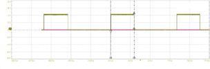

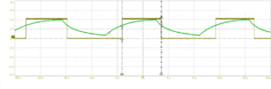

Target : I want to make square wave on Vout (Period =18 sec on :8 sec off: 10 sec)
I have problem when I use scope to measure triangle and Vout , I have followed target. But when I use scope to measure Vout only, time Period and time on reduce. it's not followed target.
I don't understand.
Q: why measure triangle signal and no measure, it's too difference.

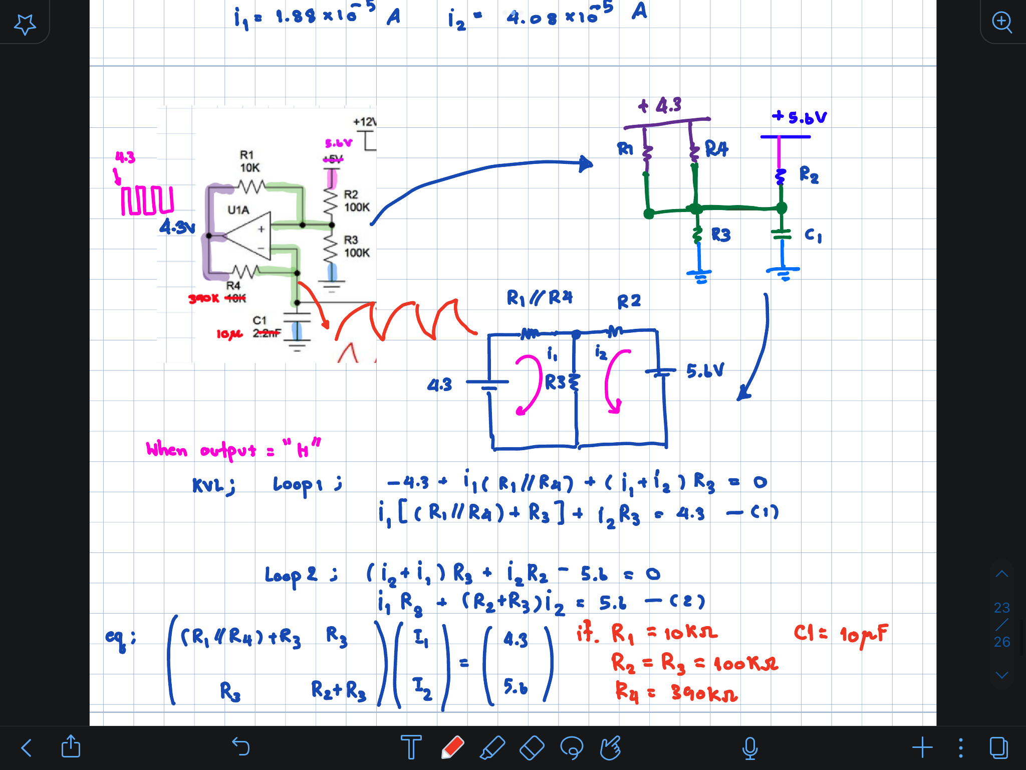

My calculation.
file 1 &2
Please check my calculate is right?
If wrong, I would like to know how to calculate.

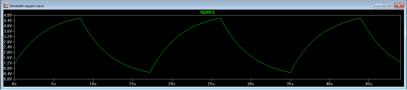

We've got problem for this circuit
I calculate charge and discharge time not same with simulation.
This is simulation of triangle signal.
Charge time: 8.97 sec
discharge time: 8.823 sec
Period: 17.79 sec

From my calculated
I use op-amp : NJM2904C
From data sheet : Vop = 5.6V -> Vo = 4.3V
I got this equation.
I solved for I1 and I2
I1= 0.026mA
I2= 0.015m A
R3= 100k
Find Vc1 = (I1+I2)*R3 -> 4.1V
Calculate Charge : Vc=Vs" (1-" e^((-t/RC)))
t= -ln[1-(Vc/Vs)][RC]
use R4=390k and C=10uF , Vs = 4.3 V , Vc = 4.1V
t =
11.96 sec
SIMULATION Charge time: 8.97 sec
It's not same with simulation. I don't know mistake point.
Please guild me to calculate this circuit.
THANK YOU
The circuit charges and discharges the capacitor most of the way to fully charged and fully discharged. The simulation shows that the charge and discharge times are more than twice the time constant, which is RC, so 390 kΩ * 10 μF = 3.9 seconds.
The result is that the voltage is changing very slowly, so minor adjustments to the voltage will make a big difference.
In this case I think that it is the output voltage of the op-amp when high that is having an effect. You have calculated with the op-amp producing 4.3 V while the simulation produces a higher peak voltage.
Also the target voltage should be 4.05 V if your output voltage is 4.3 V. That may be more important than changes in the output voltage as the target voltage changes as well if the output voltage changes.
Here is a tip for a quick way to calculate the voltage of the common point of 3 resistors. You take one pair of resistors, and calculate the resistance of the two in parallel. In this case, the two 100 kΩ resistors give 50 kΩ in parallel. Then you take the voltage that they would produce without the third resistor, in this case 5.6 V / 2 = 2.8 V. Then you calculate the voltage that the third resistor would create to a voltage and resistance you have just calculated, so a 50 kΩ resistor connected to a 2.8 V source. In this case the voltage difference between 4.3 and 2.8 is 1.5 V. The 10 kΩ and the 50 kΩ divide that by 6, so 0.25 V across the 10 kΩ resistor, and that gives 4.05 V.
I haven't followed your calculation but your equivalent circuit shows the 390 kΩ in parallel with the 10 kΩ which is incorrect. Where an op-amp is used as an amplifier, in some cases you regard the op-amp inputs as being at the same voltage. Here, it is used as a comparator and there is a significant voltage between the inputs of the op-amp except for the brief moments when the output switches.

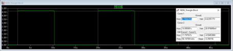

I am getting .16 Hz :
You can see as R4 is dropped, lowering Hysteresis, signal freq rises substantially :
Part of the inaccuracy problem is inputs are going outside their Vih CM spec, in the first sim,
so all bets off what the timing is in this portion.
