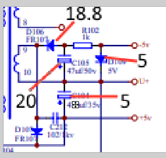

I bought a HY3020 power supply years ago. Stored it and forgot all about it. Just powered it up and it works for a bit then it shuts down. I loose power all the way back to the opto and SCR. A feedback loop I guess, but this thing is beyond me for sure.
Anyone feel like giving a hand. Been years since I have touched any real circuits (esp analog). I have the schematic and will attach it. I have a small PS, but would like the extra amps if this one can be figured out. Just a random shutdown is a pain to trouble shoot. But willing to perform tests here if any takers.

I found -C105 to +c104 25.3 volts on and off if I recall. c406 was 12.3vdc (not 30vdc) ON and when off 1.2vdc (switch on)
No standby or buttons.
Could not find C10 or R2 will look when home. Did find C2 but hard to check.
What I have across the parts with it working (first image). display on and driving a 12volt load. All shows mvolts there when it cuts out.
On the 30V there was 12.3v on and working (display and power out), and 1.1v when it blanked display and no output
here across c406.
here across c406.

here is what I have so far. Looks like one side drops out (fig. 2). When it starts (and works), it goes from 11v and slowly bleeds down to .2mV on all the points.
The TOP223 looks like it stops oscillating. Could be a defective TOP223 or it could be the TOP223 operating properly and shutting down with an overload. Might try disconnecting H1 and H2 (lift one end of D105 & D108) and see if the +/- 5 volts stay up.
Ylli. I pulled the diodes and caps D105 and D108 (caps were piggy backed in sam holes). Got the +5 and -5 from U+ (transformer pin 10). So that is good.
does that tell the circuit area of the bad part? I did not put them back in yet. The cap and diode pins are in 1 hold on the PCB. Want to make sure OK to put them back in.
There are two subcircuits there, H1 feeds one and H2 feeds the other. I don't pretend to be an expert on switching supplies, but from where you are at I would try reconnecting H2 by reinstalling D108 (and it's cap). Fire it up and see if it that +/- 5V continues to operate.
If it does not, then the section driven by H2 has some problem. If it does, then the section powered by H1 may be the issue, and that would be the place to look.
Looking at the data sheet, the only way the control pin of the TOP223 can still have 6V on it with no voltage across the LED is if the U101 optoisolator transistor is leaky or shorted; or Q101 emitter is open circuit?
Check the base voltage on Q101; if that's less than 1V, try replacing the opto isolator.
Or the TOP223 has failed - but if that was the case, the 9V bias circuit that feeds the opto should also be dropping out?

H1 out R105 and r108 h2 in, +5(opto) and -5 there until it display/power drops out. Then -5 stays D109/R102 but opto 1 and 2 are mvolts. Opto pin 3 is 5.5v and pin 4 is 6.7v. opto all from Transformers pin 5
rjenkinsgb, thanks for looking I have .6v on Q101 base.

So with D108 reinstalled and D105 still out, the unit shuts down. How long does it take before it shuts down?
See the attached. Connect the negative voltmeter lead to the point shown in black. Connect the positive meter lead to the point indicated +1. Turn the unit on. Before it shuts down, what do you measure for voltage?
Now move the red lead to +2. What is the voltage there (before it shuts down)?
I hooked both back up R108 and R105. But have 44vdc cross C106. 24vdc to r414 from - c106. But H1 and H2 hooked back up. That OK
Also when it cuts out (5-10 minutes) 58 volts and a slow drop on R414 and cap +
