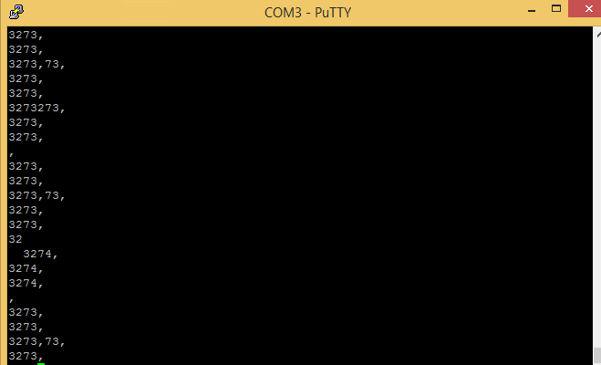

Hi everyone,
I'm a new programmer of dspic33f and facing issues with getting ADC working with DMA. I'm using dspic33fj128mc804 and need to read 8 analog readings using DMA. The problem is that I can see the values on putty but however the values are not always correct. For example: in case of just printing one readings I get the below output.
Can anyone please help me with this , please?
Below is my code and the screenshot of the output.
Thanks much in advance!

IMHO, the problem is most likely the UART transmission rather than ADC. It looks like some of the characters get lost. This could be if, for example, you write to UART too fast, without waiting for the buffer. Once you fix that, you can work on ADC.
Thank much for your reply. I have tried increasing the baud rate but still no luck !! Can you please suggest anything else that could be wrong or missed?

Looks fine. May be you don't call your processUART() function often enough. On every invocation, you only send one symbol, so if you write more symbols than the number of processUART() calls, the buffer will overflow. If that's the case it'll be ok in the beginning (until the buffer fills in), but then it'll turn into something similar to what you see on the screen.
Thanks much for your reply. I'm calling processUART forever . Its in while(1) loop in the main code. Is there anything else which I can try or how to manage the size of UART buffer? Could you please provide some insight into this please?
"Forever" may not be enough. You main loop runs at some frequency (F1), and your ADC produces data at some frequency (F2). If F1 < F2, then your buffer will overflow. If you observe the pattern I described (good at the very beginning, then screwed) this is definitely the case. If that's the problem you can change your processUART() function so that it could send more than one byte.
