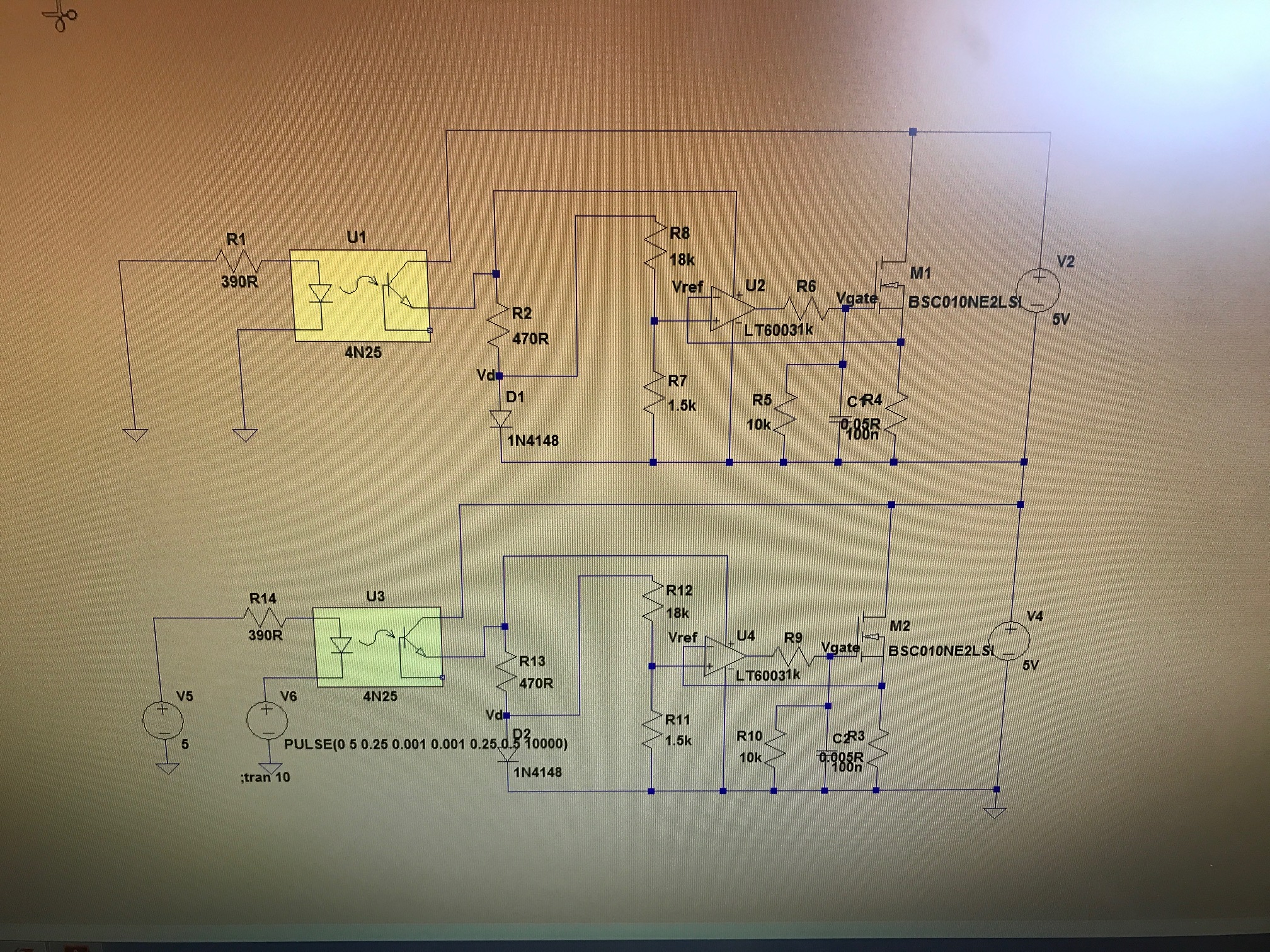

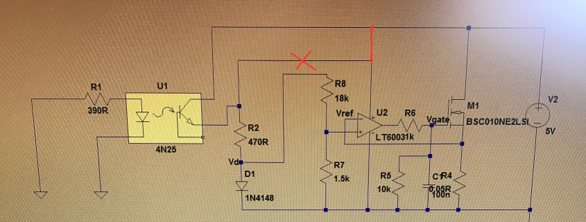

Hi all I have designned a pcb to balance batteries, by using MOSFET's in there linear region (act like resistors). I have designned this circuit to balance 6 batteries the problem I am having at the moment is that, when I apply a voltage across one of the circuits (i.e. C1+ and C2+ of 5V),the other circuits are turning on and I am measuring 5V at the emitter and collector of each of the other optocouplers. However I have not turned on any of the optocouplers there is no voltage across the diodes of the optos. Can anyone please advice. Below are images of the circuits I developed, I have basically repeated the circuit below 6 times in series this image has two of them connected up with a simulation I created is also attached I made in LTSpice. Can anyone else explain why, the top circuit, there is a voltage at the emitter of the circuit, and also why the MOSFET is turning on when there is no voltage across the diode of the OPTO. Thanks Art

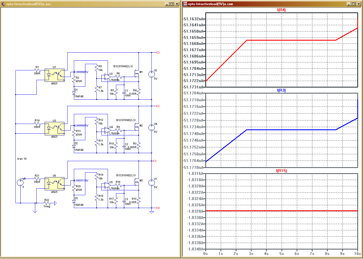

Hi have made an updated version of the simulation which should hopefully explain the circuit I have setup, I have built a PCB to test this and the test I am currently carrying out I have added in the simulation i.e. only turning on the opto of one of the circuits. The problem I am having is that the other circuits are then turning ON i.e. voltages measured at the emitter and also at the gates of the FETS when they shouldn't be ON because their optos haven't been turned on. Also sorry this was an older simulation it was meant to be 6 5V batteries. Please let me know if I have gone wrong anywhere or what can be improved so that it functions in the way intended would be greatly appreciated. Thanks Art

hi A,
You have the 'vgate' label assigned to two points in your circuit, so what is on the lower active Vgate will appear on theUpper Vgate.!

Hi yeah just noticed that it was an older simulation, the most current one I have posted should have the setup I am considering
Although you measure 5v across the opto transistor, the opto transistors are not conducting.
Also I measure no current flowing the main power FET.??

Alright damn, completley forgot to look at current, so just to double check, althought there is voltage measurement there is no current flowing from the Drain to the Source? I can't believe I forgot to check current
hi A,
This is what I see with just 3 batteries, the bottom opto is enabled.
Note I have changed the COMMON and Gnd Ref to suit my tests.
E
If you still have a problem try disconnecting several of the opto outputs that way they can not turn anything on even if damaged.
No this is fine I made a mistake with my interpretation, there is a voltage present at the collector and emitter of the opto but there is no current flowing between both. Thanks Art

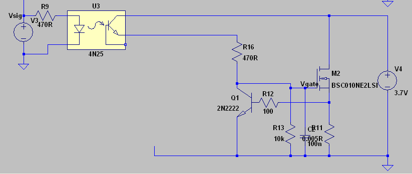

Here is one with a transistor not an op-amp. I am getting 2.4A.
  • opto-fetactiveload-ron.asc
What is that transistor there doing for us, limiting the current to 100 amps? :)
I have a feeling that 2.4 amps is due to the transconductance of the mosfet only.
I don't know why I said 2.4A. Now I am getting 13A.

Hi again Ron,
If you look at the sense resistor in that circuit is it only 0.005 ohms, so it would take about 100 amps through the mosfet to get that transistor to start to turn on. With 0.05 ohms, it would take about 10 amps. With the original circuit and same sense resistor values it would be about 10 amps and 1 amp respectively which unfortunately is still not right because the circuit will not function as balancer as is anyway.
