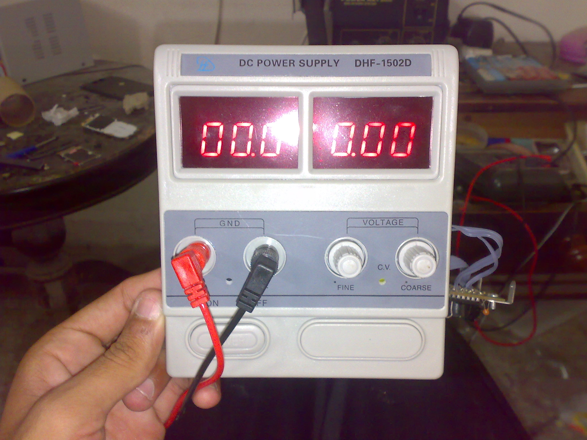

i am facing a problem now a days
problem is that i had bought a power supply from market, and it makes PROBLEM from the FIRST day i had bought this
well PROBLEM is that, when i Swith ON the supply, display(DIGITAL VOLTMETER) works, but showing 0000 VALUES
when i vary from KNOBS, then nothing is going to happen
i open the POWER SUPPLY, and check fro the whole circuit that might be, if any thing burnt in it, then i must reploace, but every thing is OK from INSIDE
i study this supply since last week but uinable to LOCATE the EXAXT FAULT
if any one of you have any IDEA about this FAULT then must told me
i also mention that, i CHECK VOLTAGE from DIGITAL MULTIMETER at different part of power supply, it SHOWS (20V DC) which mean that transformer is OK....
so plz help me about this issue

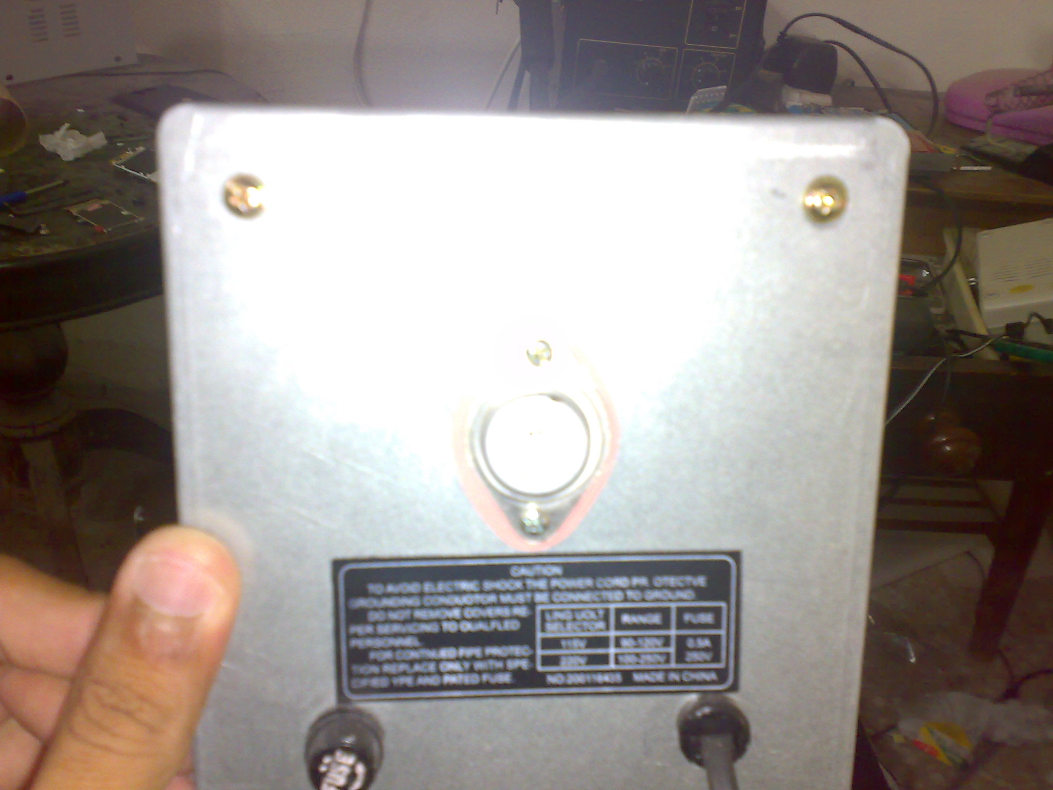

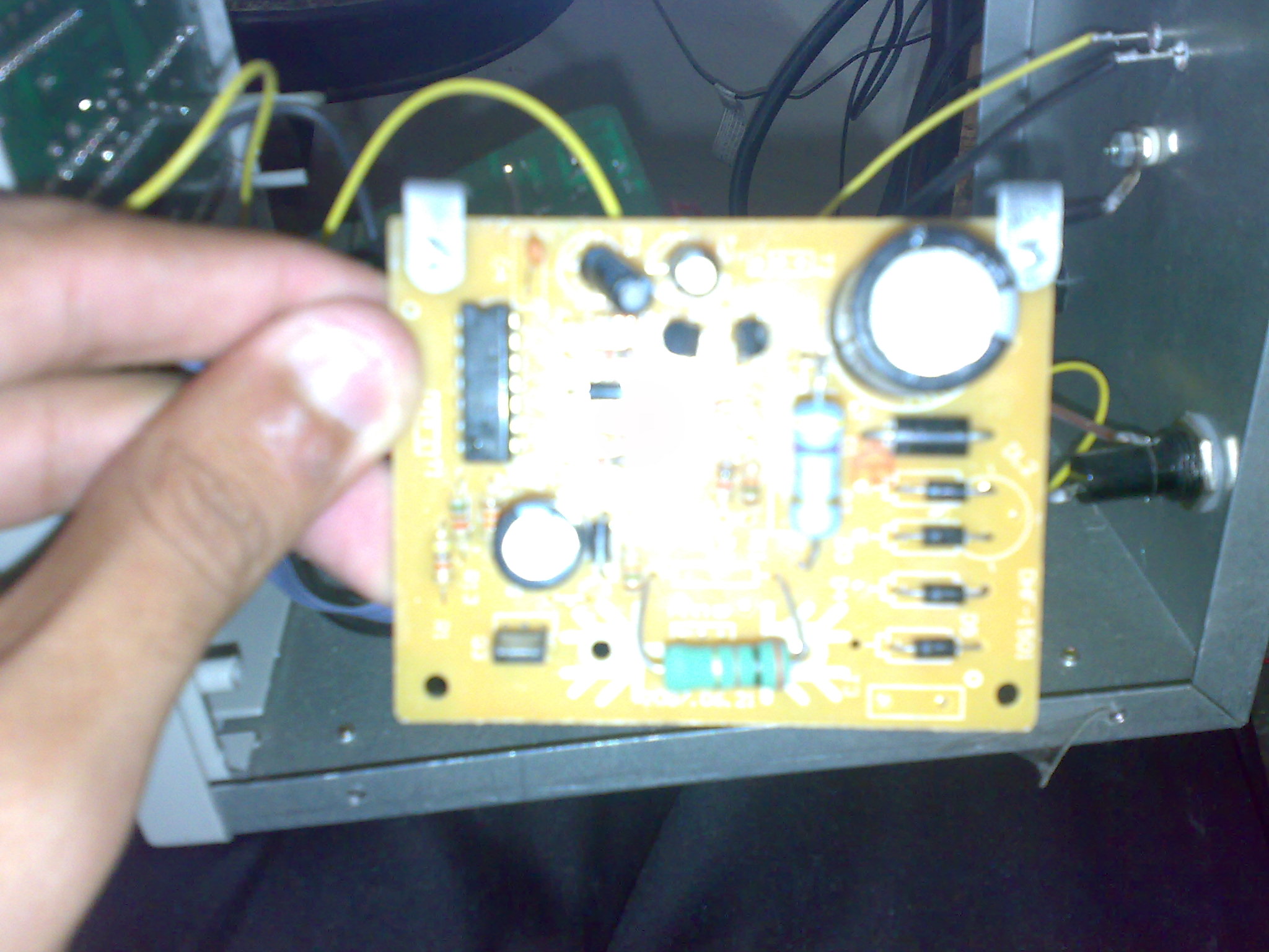

Having looked at the first picture, if there's no output from the power supply,I'd put money on the series element being o/c...or something there abouts..

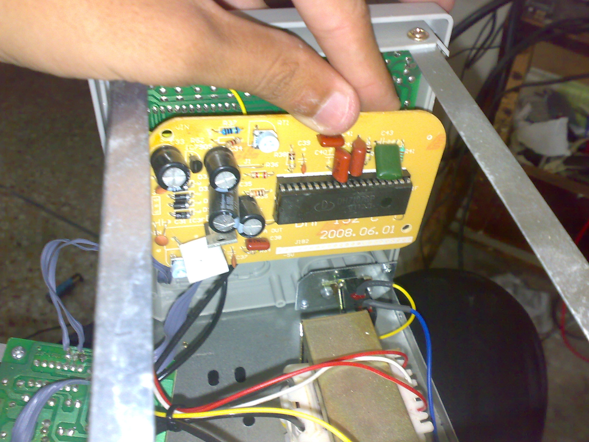

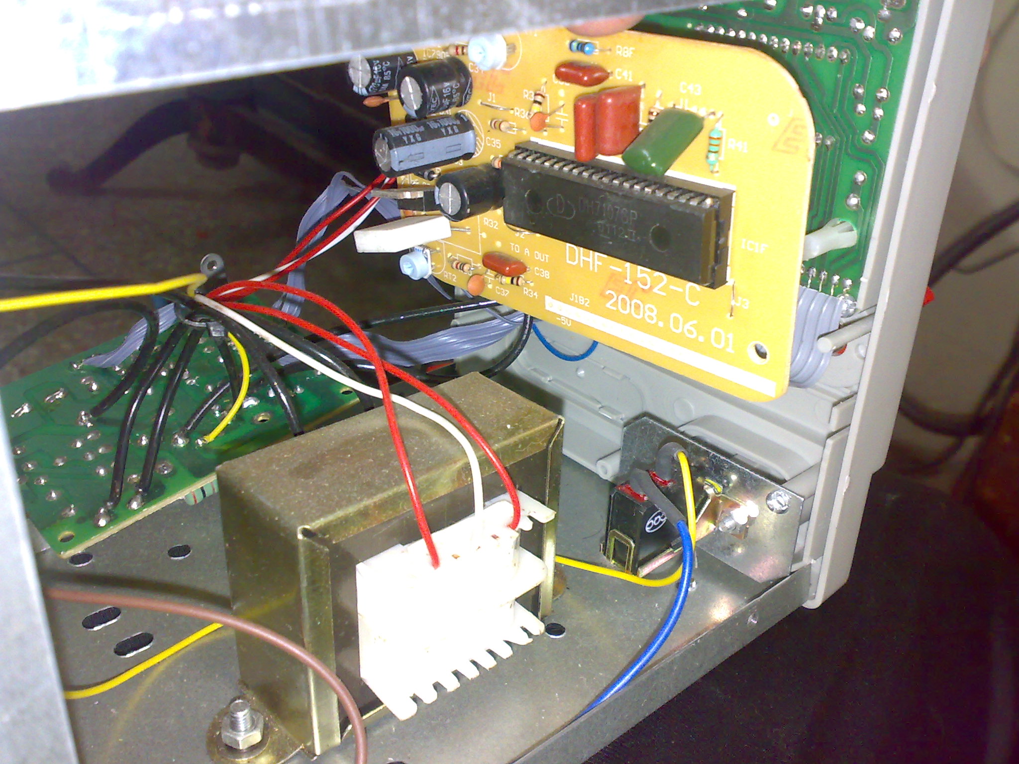

Look carefully a the black wires that go from the transformer to the green board. One of them doesn't look properly soldered.
