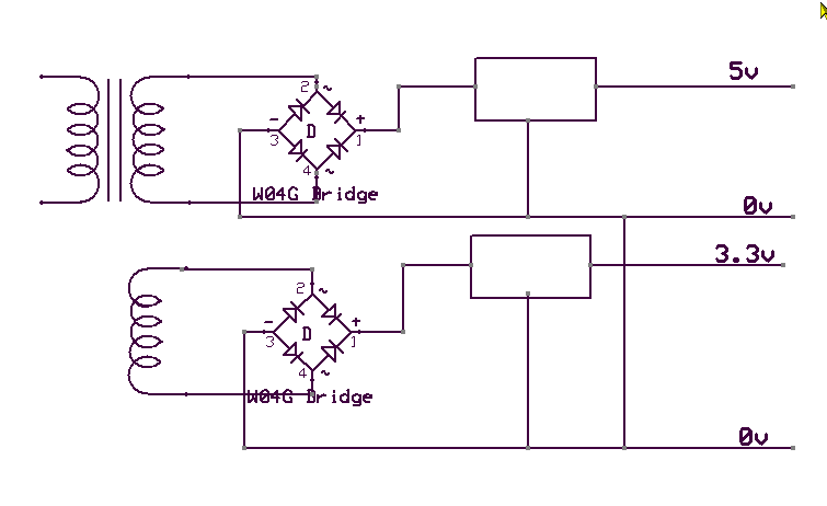

I am using a dual output (secondary) transformer (2 x 8v). The two transformer outputs are two independant windings (eg. four output pins, thus no center tap). I want to keep my 5v circuit separate form my 3.3v circuit, so I use one secondary winding to power a 7805 regulator and the other secondary winding to power a 3.3v switching regulator circuit. Each winding first goes through its own diode bridge before going to regulation. In summary - two secondary windings - two diode bridges - two regulators.
Now my processor runs off the 3.3V and it switches transistors which switches relays which run off the 5V. So where do I connect the transistor's emitter? To ground that comes from the 5V's winding or the 3.3V's winding? Does it matter?
Let's say I want to use my processor to interface to a computer's serial port. The MAX232 runs off 5V, but the TX and RX lines come from the processor. Which ground should be connected to the MAX232 GND pin? The one that comes from the 5V's winding?
How does this work?
Connect the two 0V lines of the regulators together so that you have a common ground for the 3.3V and 5V

Thanks for the quick reply.
What would be the implication if I didn't connect the to grounds together?
The reason I am doing this is because I want to keep the grounds separate. I don't want any noise that gets into the 5v ground to affect my 3.3V ground. However, I assume that if I connect the two grounds together right at the bridge rectifiers then anything from the 5v part will not propagate into the ground of the 3.3v part.

You cannot drive a transistor base from one supply to control the action of the transistor when its 0v line is not connected.
You can tie the two -Vdc on the bridges together. I assume you have the +V lines all decoupled.?
Also if the grounds do give a problem you could use a low voltage drop 3.3Vreg on the 5V line.

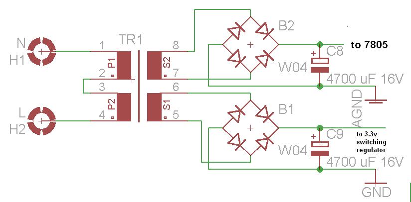

I (hopefully) have the decoupling sorted. Here is the first part of the schematic. It shows the transformer and the way that I wired it to the bridge rectifiers. It also shows the two large caps right after the bridge rectifier. Also, right after the 7805 I have another 0.1 uF cap (5V to 0V). I also have a 0.1 uF cap right at my processor voltage input pin.

I would recommend a 100nF across the 4700uF to help improve the high frequency noise filtering.
Depending upon the current loading and voltage drop on the 4700uF the bridge diodes are going have a fast/ high current pulse when recharging the 4700uF's
Again dependent upon the loads the 3.3v and 5v are powering you will require a larger value decoupling cap than 100nF across the regulated outputs, say a 470uF or so in parallel with the 100nF
Thanks for the advice Eric. My processor setup will probably draw 200mA max. If all the relays are on you could probably add another 200mA. So there should be no reason to exceed 500 mA overall at any one time.
The bridge rectifier can handle 1A, while it has a surge overload rating of 50A. The transformer can provide 0.875A on each secondary winding. Is this OK for the charging of the 4700 uF cap?
