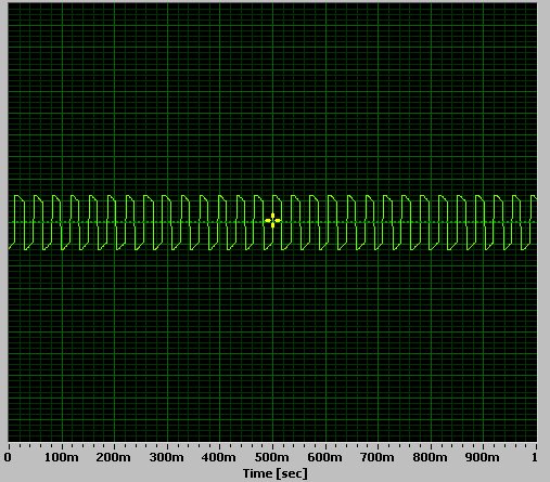

hmm... kjennejohn it seems i don't get what you're trying to say...
the multimeter i'm using has Hz/DUTY button. I'm selecting "duty" and
i'm putting the first probe on the output pin of the microcontroller (before the resistor for the led) and the other to the (-) of my power supply and i don't get any reading... the same happens even if i choose "Hz" (the led blinks about 2 times per second)
few minutes ago i tried to measure the output of a 220V/12V transformer and i got surprized because i could measure 49.93Hz and 49.8% duty.
what's going on?

still i can't measure duty cycle with my multimeter.
here's what my microcontroller outputs to a software oscilloscope connected with a sound card..
help :rolleyes:
ok so.. from the above what i understand? that i can't measure duty cycle and Hz on a circuit which outputs square wave like the case with the microcontroller i'm using?
If you can increase the frequency of the square wave without changing the duty cycle... bump up the frequency to one your meter can measure.
If or not you can change the freq without changing the duty cycle depends on the software used to generate it.
Bills suggestion will work in any case.

Your meter spec say 10Hz is the low end of it's frequency counter, so at least 10Hz.
The simulator has no such limitation.
few posts above i have uploaded a photo... isn't that well over 10Hz?
i guess that the multimeter should be able to measure that frequency and also show duty cycle... but maybe i'm making something wrong? the user's manual says:
Remarks.
* The inputed voltage is sine wave.
* When 10-Hz~10Khz: >1V rms
* When 10Khz!100Khz: >30V rms
at first i didn't knew that i can do like you said...
it's just dissapointment that for some reason my multimeter can't measure such things. One reason i bought it is to do such things.
