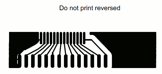

Glad to see it works. I picked up 20 of these little displays for teaching breadboarding. I etched a PCB that converts the .05 inch pin header to .1 inch. The header pins are soldered flat to the PCB as if they were surface mount. On the .05 end I flood the pins with solder and the knock off the excess by tapping the PCB on the workbench. Solderwick would work too.
You can epoxy the bottom edge of the PCB to the black blob on the back side of the display for more strenght. The image shows the LCD inserted behind a processor module.

Here is a PDF of the PCB.
