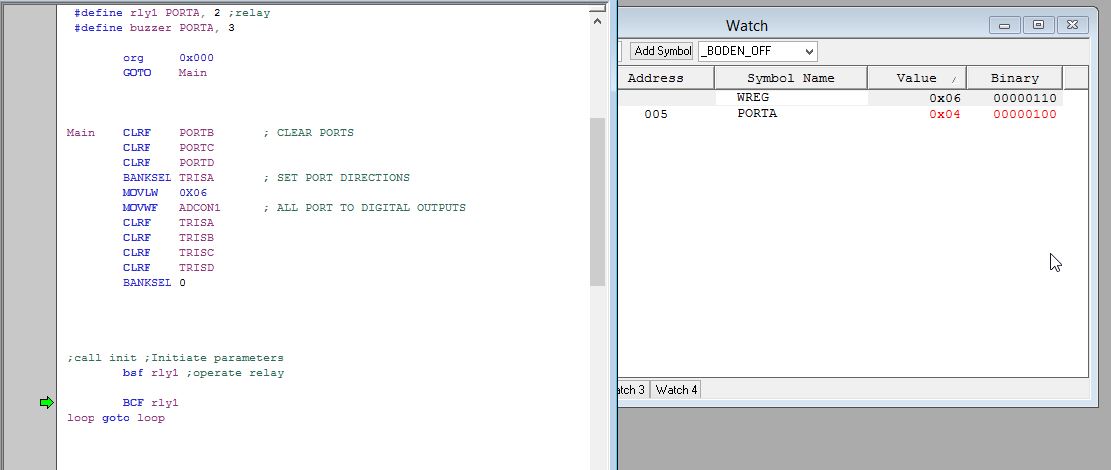

As Ian says turn off the comparators or ADC
As the pic shows, it runs ok, but when defined as 'rly' the watch window changes to 0x04 when the TRISA is executed ? changing it to 'rly1' then it changes correctly to 0x04 on the BSF instruction (v8.92)

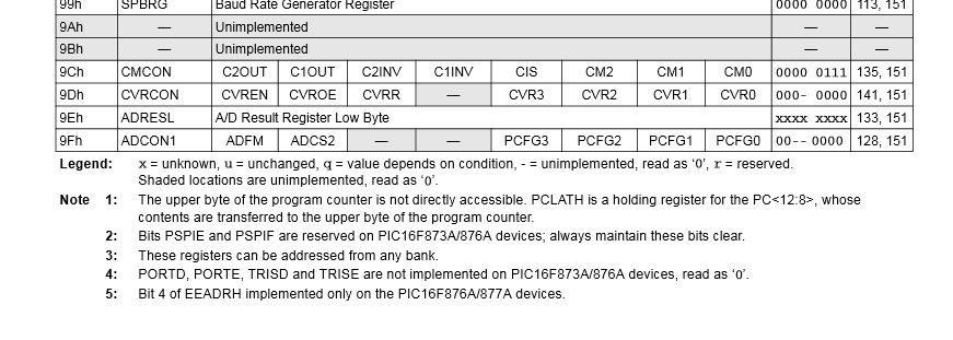

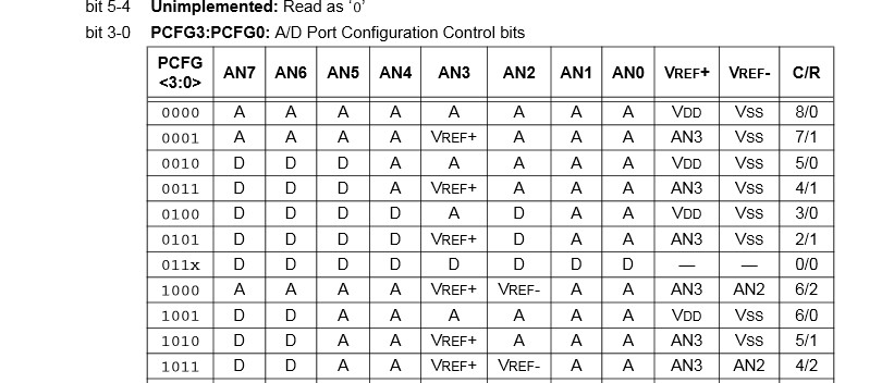

The ADC is already off. It's all about pin mode assignment.
If you're using pins that are multiplexed with the on-chip ADC, you have to write to the appropriate register to assign these pins to digital I/O mode.
Which PIC are you using?
Not on microchip they aren't.... You HAVE to turn them off... I have been stung too many time with this...
The ADC module is turned off at reset (ADCONx). It's the Analog Select Register (ANSELx) that set the I/O port pins to analog input, disabling the digital I/O buffer on reset.
All academic as we dont know the pic... Not all pics have ansel registers... The original pic's were all enabled... the newer ones have the ansel registers on o boot... either way you need to disable them..
Regardless of the legacy version or newer, the ADC itself is always turned off on reset. On legacy processors, analog/digital mode was selected by writing a value from 0-F to the LSB's of the ADCON1 register. ADCON0 contains the ADC On/Off bit, which is always a 0 on reset.
Either way, it all has to do with the pin mode selection.
If the processor has an ADC then you have to disable it!! Which processor are you using??
Thanks for that suggestion, it fixed the issue.
I'm using a 16F628A. I had forgotten that it has analogue inputs as it is a long time since I last used one
Thanks to the others who responded.
