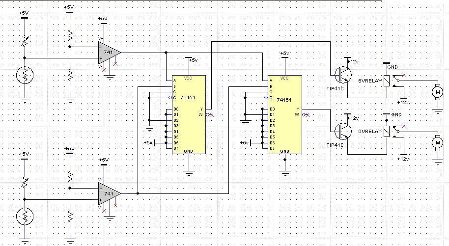

Can't solve the problem. Here's my schematic. In my schematic where it says 5V, I have used +5.9V.And when I use MM74C151 it works fine but 74LS151 doesn't do what it should! hELP ME OUT!

I dont see any schematic.:confused:
I see it now.

I would say its the 741's thats the problem, powering them with a +5V rail, I suspect the outputs of the 741's do not goto thru the switching thresholds of the LS151's.
Can you measure the 741 outputs [high and low] and tell us what they are.?
A lousy old 741 opamp is not supposed to work when its supply is as low as only 5.9V.
If it does work, its output low voltage is about +1.2V.
The maximum allowed input low voltage for an old TTL IC like a 74LS151 is +0.8V so of course it won't work when fed from a 741 opamp.
The maximum allowed input low voltage for the Cmos 74C151 is +1.77V so of course it works.

741 O/P: High- 5.53V
Low- 2.24V
Should I use CMOS IC?
That lower voltage is the problem, its not a logic low for the 74LS.

Do you have access to the LM393 dual compartor.?
This would replace the 741 OPA compartors, use a 4K7 on the outputs of the LM393, a 1mA sink current should give a saturation voltage of < 0.5V.

We seem to be going around in circles, the 741 is NOT suitable for this application.
Whats the point in 'fudging' the circuit to make it 'sort of work'.
A LM393 dual comparator will take up half the space on the pcb as 2 * 741 do, also it will consume less power from the battery pack.
