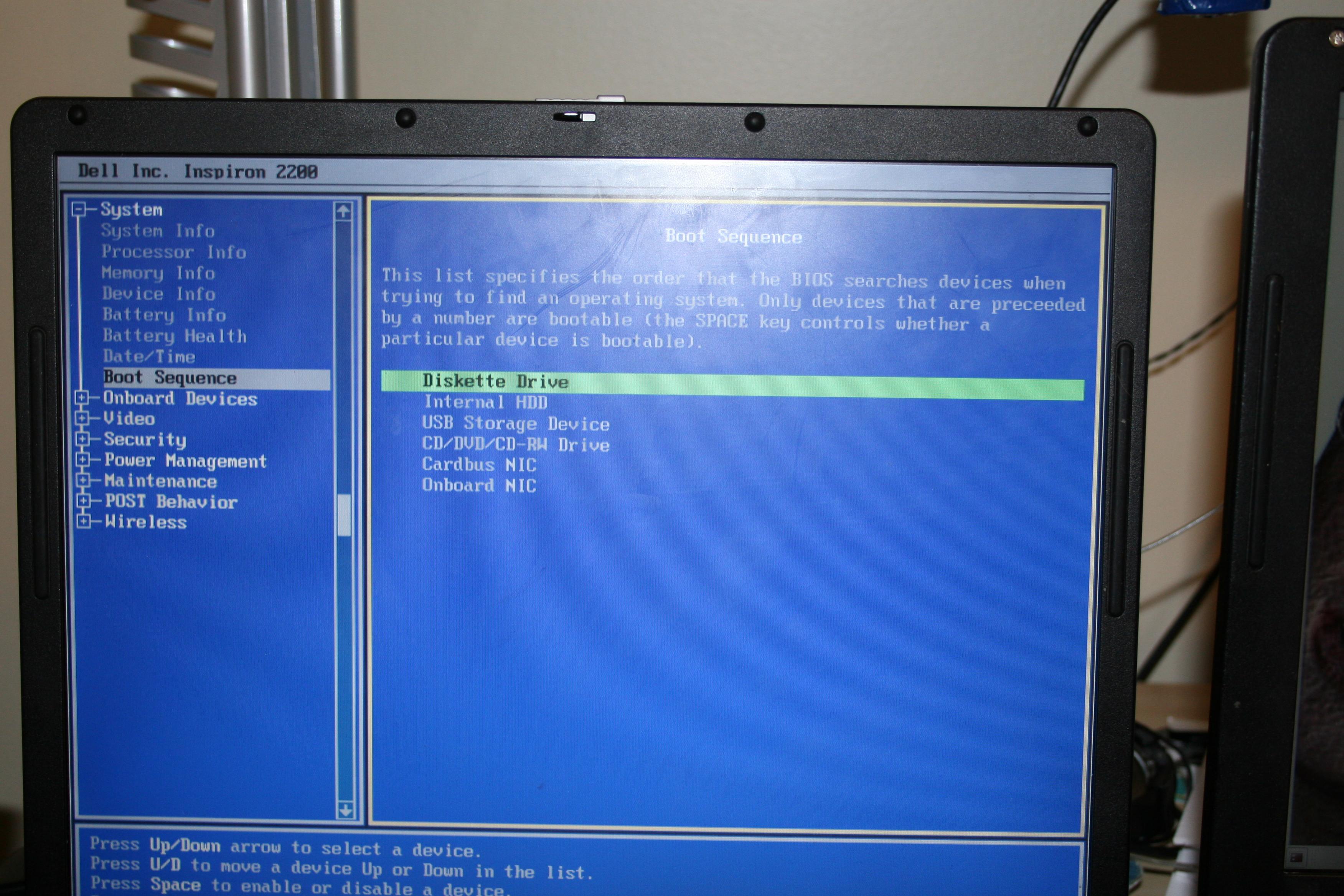

hey there, i recently acquired a dell 2200 from a friend, it appears to be in very good condition, when i load it up, it says; failed to startup windows, and it gives me boot options like: open in safe mode, open in last working mode, and just open windows, i don't remember exactly, i should have written it down, and i cant look at it because i need the same power cable for that as i do for this laptop. no matter which option i click, i end up with a black screen with a mouse on it (which will move), what should i do? has anyone had this problem before?

hey there, so this is how far i got, i'm not sure if i will be able to get there again, so i dont want to mess anything up. where do i go from here? i just make it look in the cd/dvd/cd-rw drive for an operating system first right? once again thanks for the help

when i try to make it look in the dvd drive first, that works, intil i try to make it look in the hdd second, then it makes that first and the dvd drive second arg! should i just try to make it look in the drive and forget about the internal hdd?
highlight the dvd drive and press the "u" key until the dvd drive is above the internal hdd. also make sure you have enabled the drive by pressing space if it is disabled.
if you still cannot load the drive disable the hdd. this will not stop the hdd from working but once you have repaired the drive you will need to re-enable the drive so it will become bootable.
However make sure you press f10 or the button to save your changes.

Note: 1. Try holding down the 'Ctrl" key and the F11 for the OS reload.
2. F12 at boot will send you to the CD for boot without going through the F2 choice screen.
