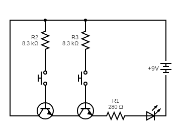

Here's an AND gate I built for practice and it's working with one quirk. Whenever I press the button closest to the LED by itself, the LED dimly lights up. I think there's enough voltage going through the transistor base/emitter to power the LED. How can I prevent that from happening? If it matters I have my calculations below. FYI I'm new to circuits so please talk to me like I barely know what all this means... Thanks in advance!

R1 Resistance
Vin = 9V
LED = 3V drop / .02A
Transistor 1 = .2V drop
Transistor 2 = .2V drop
R1 = (9V-3V-0.2V-0.2V)/.02A = 280 Ohms
Transistor Base Current
IC = .02A
HFE(MIN) = 200
Overdrive factor = 10
IB = .02A/200(10) = .001A
R2 and R3 Resistance
VBE(sat) = 0.7
R = (9V-0.7V)/.001A = 8300 Ohms
You can also put a shunt resistor across the LED ... something like 2.2k or so. We see this a lot with the newer LEDs that are very sensitive to micro currents.
In your case the transistors BASE's are floating allowing them to behave like an antenna for anything attached to them. A resistor from the Base to the Emitter on each transistor will minimize this current as well. Anything from 10k to 100k should be fine.
When you say shunt do you mean bridging the positive LED to ground with another resistor?
Bear in mind how a BJT transistor have an equivalent circuit as two opposite diodes:
That is you'll see a dim light from the LED - small current through R3, R1 and base-emitter of the rightmost transistor.
