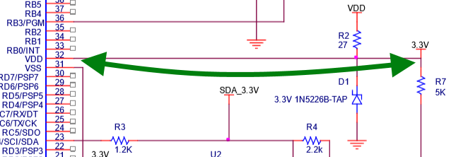

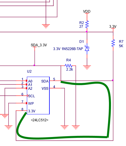

I do not understand
1) EEPROM power pin 8 is connected to SDA pin-5?
2) What voltage for U1-32 VDD? It looks like 3.3V.
3) What voltage for U2-8? It looks like 3.3V.
I have questions about your voltage dividers but I need to know the supply voltage(s) first.

It's all rather bizarre? - not mentioned so far is the lack of proper connections to pins 11 and 12, it's important that ALL Vss and Vdd pins are connected. But there's so much on that circuit stopping it ever working it's hard to know where to start?.
The points marked 3.3V are connected together. VDD on the PIC is 5V and I have a voltage divider to get 3.3V to the EEPROM. The voltage divider on the SDA and SCL are making lines pull down, then I will remove the voltage divider. The EEPROM can run between 2.5V and 5V.

I do not understand
Answers:
1) that is a mistake on the schematic, sorry. Pin 8 isn't connected to SDA pin-5.

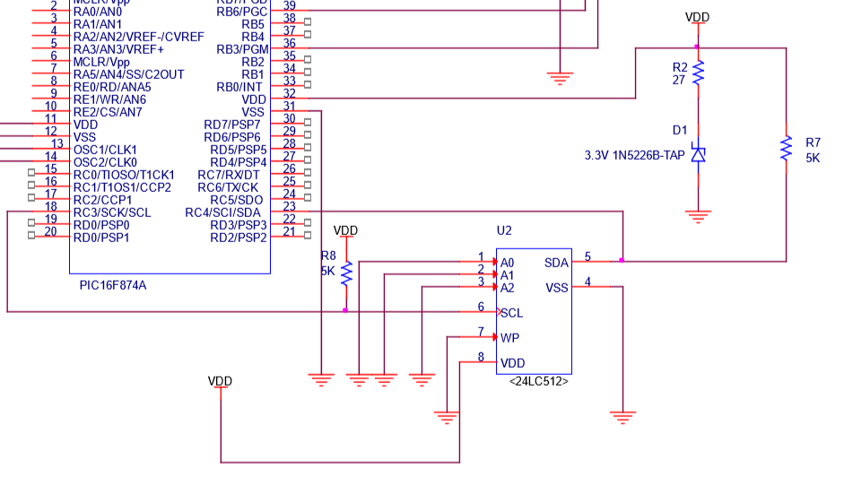

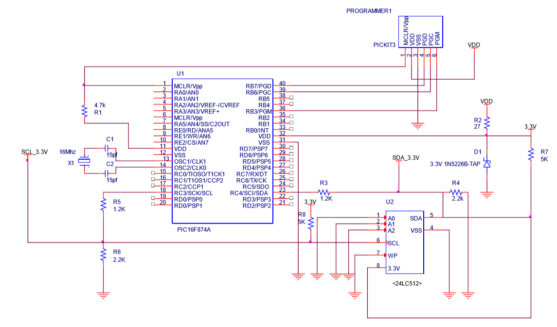

I made mistakes on the schematic. I think I fixed the errors and I re-posted the schematic.

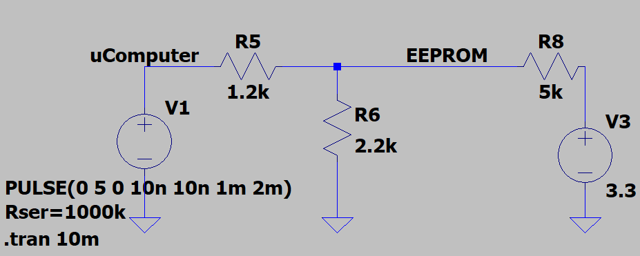

I have answers.
The schematic is drawn wrong. So I will go with the words.
Pictured below. The point "uComputer" is a pin on the computer. The point "EEPROM" is a pin on the memory.
Computer is powered with 5V and its outputs are low=0V, high=5V, or tristate when they are an input.
When the computer is driving a pin the divider works. H=3.2V L=0.5V which is ok. Assuming the computer drives the pin high. Actually a high should be made by tristate-ing the pin and allowing the pull up to bring the pin high. When this happens the pin goes to 1V, because the divider is not right.
When the memory is sending data out we have a big problem. L=0V but H=1V.

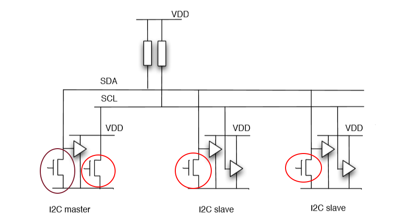

Many people write the software so the computer drives the pin high. The I2C bus was built for the only pull up is a resistor and no silicon pulls up.
The EEPROM does not pull up. A pull up resistor pulls up. 5K to 3.3V and 2.2k to ground makes about 1 volt.
I would do 1) or 2):
1) Make all ICs run on the same power supply and remove the voltage divider. Keep only the pull up resistors.
2) Fix the software so the computer does not pull up to 5V but turns off the port and let the pull up resistors pull up to 3.3V. (remove the divider)
and read the I2C bus specifications.
I drew a red circle around the pull down transistor in each IC. There is no pull up transistor.
You've still not addressed pins 11 and 12, and what's with the crazy I2C connections - either run the EEPROM at 5V, or run the PIC at 3.3V - don't try to run them at different voltages - and why would you?.
I had a voltage divider because I previously was communicating with an SRAM chip using SPI and the SRAM chip only ran on 3.3V. I removed the voltage dividers on SDA and SCL. I posted the schematic with the changes. Pin 12 now is shown connected to ground. Pin 11 is connected to the pickit3 and a 4.7K resistor. I am now getting a signal on SCL, after removing the voltage divider. When I run the program it gets stuck waiting for the slave to acknowledge in the w_I2C() function. I'm not sure what is wrong with the code.
