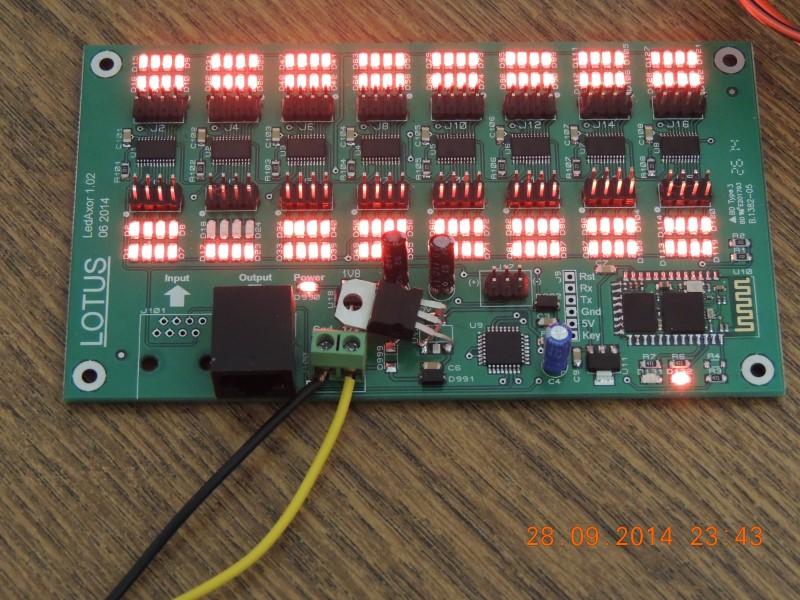

Hi all, the problem i have is this STP16C596 chips get blowns up output pins. I tried everything, searched the whole resources i can get, read the datasheet many times and i have found no problem, the board should work. But when i connect 128 leds to my board, it works for 10 minutes or so then random outpins get blowns up and stays open to ground so the leds attached those pind remain lit. i send my schema please if you could examine it and turn back with advices that saves my life. Thanks

i send the photo. those small leds are for indicatiting whether the output pis is ok or not. 8x16 pins on the board are for strip leds to connect thier ground.

What is Vf of the white LEDs? and what voltage are they connected to? I suspect the power is to high for the chip when they are all on.
A 220ohm resistor would program the output-current to 90 or so mA (hard to read the graph,) for a total current of 16*90 = 1.4 Amps
The datasheet says that the maximum ground-current is 1.92 Amps(!), but maybe the chips overheat.
Also: are you really driving all those (8*16*90mA = 11+ Amps) worth of LEDs with a 1.6 Volt supply? A 20-watt supply at that voltage is a rare(ish) beast.
The outputs are current-sources, so you can use anything up to 16 Volts.
white leds are driven with 12v. Total of 128 strip leds are connected(6 leds per strip) , each strip consumes 60mA, thus 128*0.06A=7,68 A. 10A 12V switch power supply is connected so power should not be the issue.
Total load per chip is 0.96A which is half load what the chip takes. There are 4 different voltages on the board

If there is one white LED in each string, dropping (say) 4 Volts at 80 mA , then the driver will have 8 v/80mA across/through it, giving a power dissipation of 640mW. Sixteen outputs will be over ten watts at peak load. Try lowering the LED supply to ...um: just barely enough to light them?
The monitor LED's should have dropping resistors, because they are driven by voltage.
Your white LED's should not have resistors: they are driven by current.

OK, so this is how I see it now:
The white led has a 25 ohm resistor in series with it to give it a current of 60 ma at 5 volts.
So when you connect it to 12 volts and program the chip for 80 ma the chip has to drop about 6.5 volts.
So now the 25 ohm drops 2 volts, the led 3.5 volts and the chip 6.5 volts for a total of 12.
In this case the chip dissipates .52 watts (6.5X.08) for each led or a total of 8.32 watts for 16 leds.
Per table 5 in the data sheet the junction will rise 75C per watt. Maximum junction temperature is 150C.
Way over.
Your lucky with the red ones. I'm guessing they go out when you plug the white ones in?
You can either add some resistance to the white ones or lower the current so that the power is in spec.
