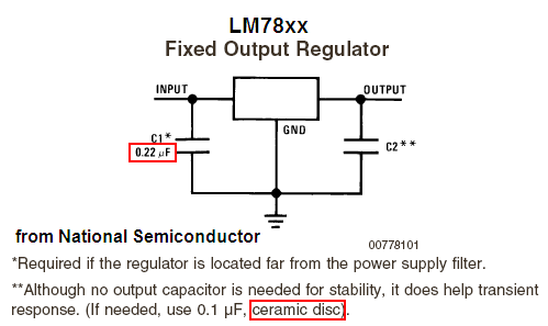

Texas Instruments say to use a 0.33uF input capacitor but National Semiconductor say to use a 0.22uF. They say to use a ceramic disc output capacitor so the input capacitor is also probably the same. Use the 0.22uF ceramic disc from Mouser as the input capacitor and it will be fine.
