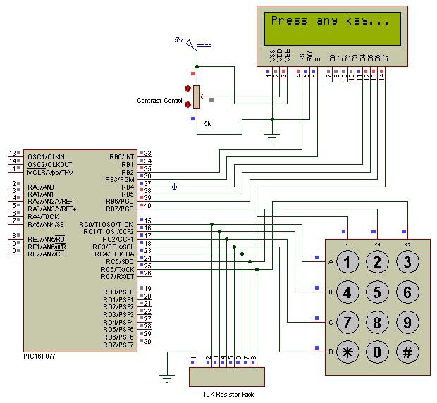

My 4x4 keypad had been connected to PIC16F877A Port C...according to this datasheet : https://www.futurlec.com/Keypad4x4.shtml
However i had programme some code into the PIC & the LCD do display something but when i press the button of the keypad, it just display the wrong key...
Example : When I press 1 >> LCD Display "0" or sometimes display different number... Even when I didnt press anything, sometime it will just display a number... & there is a Delay when i press a Key...
Wanna ask whats the problem of my circuit????
Isnt that I need to connect some sort of encoder instead of just connect the keypad directly to the Port C of my PIC???
hoe someone can help me!!!! Thanks!!
Erm.. I didnt put pullups on port C... Does this effect the interaction from keypad to PIC to LCD???? whats da purpose of pullups???

tis is a part of my schematic.....
Please use code tags, also yes you need pullups on port C. A pullup is a resistor that pulls floating input pins to VDD, usually 10K is a good choice.
chunei said:
izit because tat i din put pullups resistor that cause this problem???
yes. if you don't put pull up resistor (connected to VCC, usually 10k) or pull down resistor (connected to GND) the value read from that port will be floating when the the input is not connected, giving wrong values. Pullup/pulldown resistors give the read value a default value of 1 or 0 if nothing is connected.
blueroomelectronics said:
Add them to the 4 input lines of your keypad matrix.
erm... 4 input lines??? my keypad is 4x4 matrix.. and it should be 8 input lines right??
Nigel Goodwin said:
Read what the compiler instructions say, it's not obvious from the code - you could always stick 8 resistors on, they won't do any harm on the outputs.
You put pullups on your outputs?:confused: And, what does the compiler say?
Chunei,
You just need the pullups on the inputs.

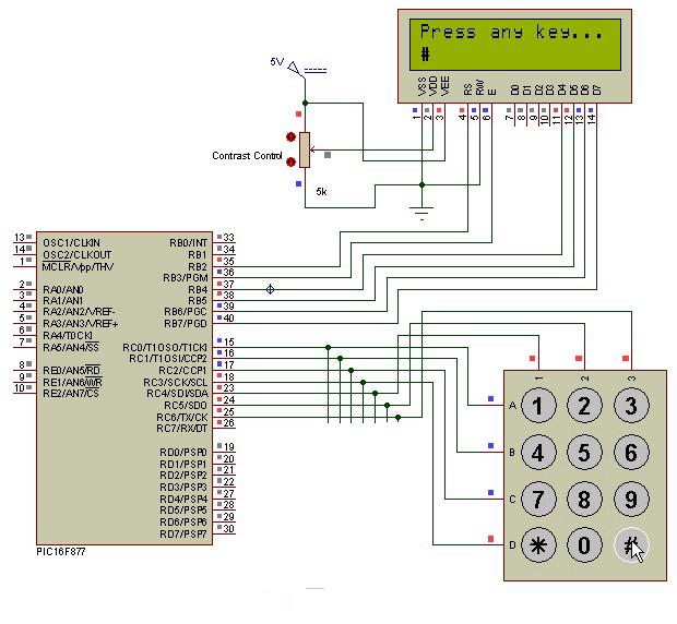

do u mean i need to put the pullups which is a 'gang resistors 10K' like in this schematic????
That'll work.
If you want to get fancy you could mux the 4 LCD data lines to the 4 keypad columns. (The resistors only need to go across the rows since you're driving the columns)
thanks for the advise.... will updates u all after i fix it...
and
NIGEL... can u tell me which are the inputs that u wan to mention????
