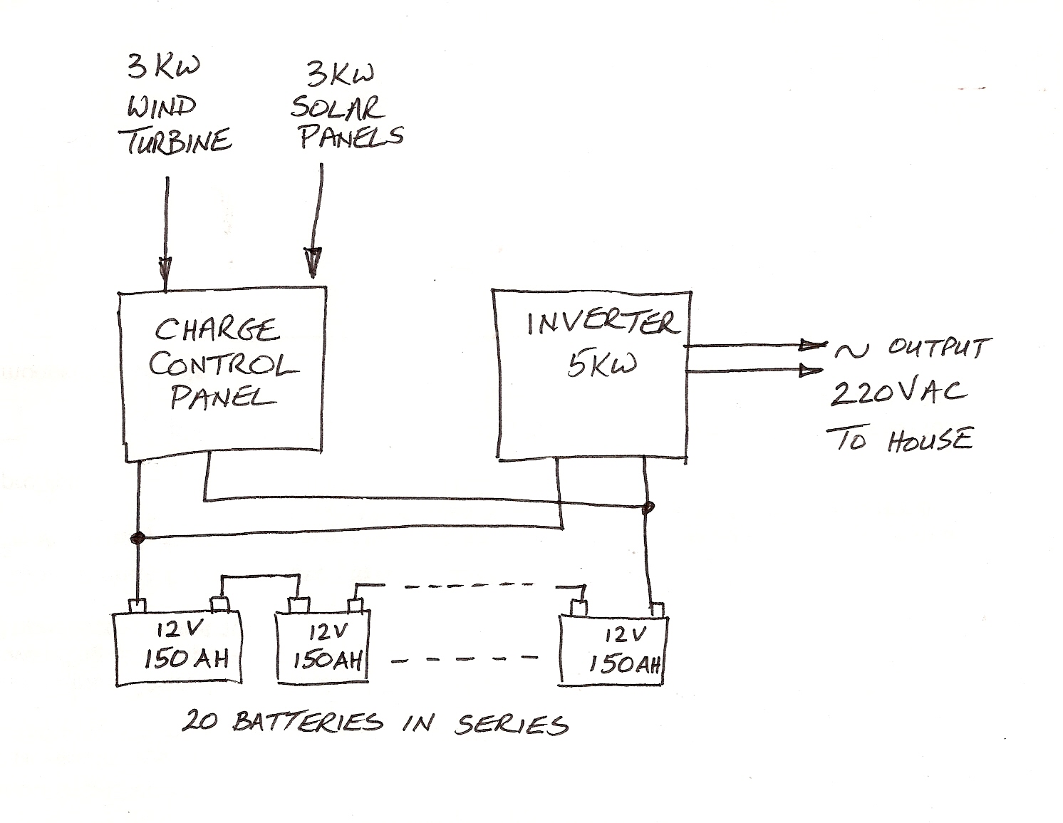

I have installed a hybrid system consisting of a wind generator and some solar panels to provide energy for my house. The energy is used to charge a bank of twenty 150AH lead acid deep cycle batteries that are connected in series. The batteries have a charge controller with a dump load to ensure that they are not "overcharged" when there is too much wind; there is also a relay to automatically reconnect the house to the electricity company should the battery level get too low. An inverter changes the DC voltage from the batteries and converts it to AC for the house.
Sadly the system does not work correctly; when the batteries are charged up (around 260 volts) and the house is connected it will only have enough energy to run for a couple of hours before the voltage level has dropped to below 250 volts and the system is ready to disconnect. When it was initially set up the batteries would support the house for at least four days without any wind blowing! There's a leak in the system somewhere and I don't know how to track it down.
The batteries seem to charge OK, but slowly. I get the impression that if the charge level drops then the battery voltage actually starts to drop slowly. There's power coming in from both the generator and PV panel cables so the batteries are getting their charge voltage alright.
I've checked all the batteries too. Every one is reading 12,XX volts so I can't see any indication of a burnt out cell causing the problem.
The inverter works OK and is not drawing an excessive load; I measured the current flowing in the cable when the inverter had no output and it was taking about 0,8A (it's a 5KW inverter).
I am getting suspicious about the cables. There are 20 jumper cables connecting the batteries in series; I made these up myself; could these be causing the leak in the system? The cable lugs are bolted to the battery terminals but the cables are soldered to the lugs. Could a poor joint be the cause of such a problem? If so, how can I check out the cables? Any other ideas?
I've included a simple sketch of the system diagram. Thanks for any advice on this subject.

The voltage drop from the negative terminal lug to the positive terminal lug, of each jumper cable connection, should be approximately zero volts. Using a DMM or other known good voltmeter, measure all the lug to lug voltage drops, using the actual battery terminal lug as the test point. If necessary, scrape the top of each lug down to bright metal, to insure that you have a valid measurement.
If you find a particular measurement that is significantly non-zero, then there is a problem with the quality of the connection. Check any questionable jumper cables to see if they are warm, a result of too much resistance in the connection.
You might also check the cables which connect the ends of the battery chain, by using this method, if it is convenient.

How much of your 150 A-h @ 240 v = 36 kwh are you now getting? The four days tells me your average draw is 400 w, about half that of the average house.
The equivalent resistance of 20 batteries in series is probably ~0.4 ohms so if you load the string with a 10A load you should see no more than a ~4v drop. A 120v 10A hair dryer probably also runs on DC voltage, so you could check 10 batts. at a time with this.
For more precision add in the resistance of your 20 jumper cables.
Depending on the results of this overall test, you could charge and load-test each battery individually for capacity. One or more could have a bad, sulphated, cell.

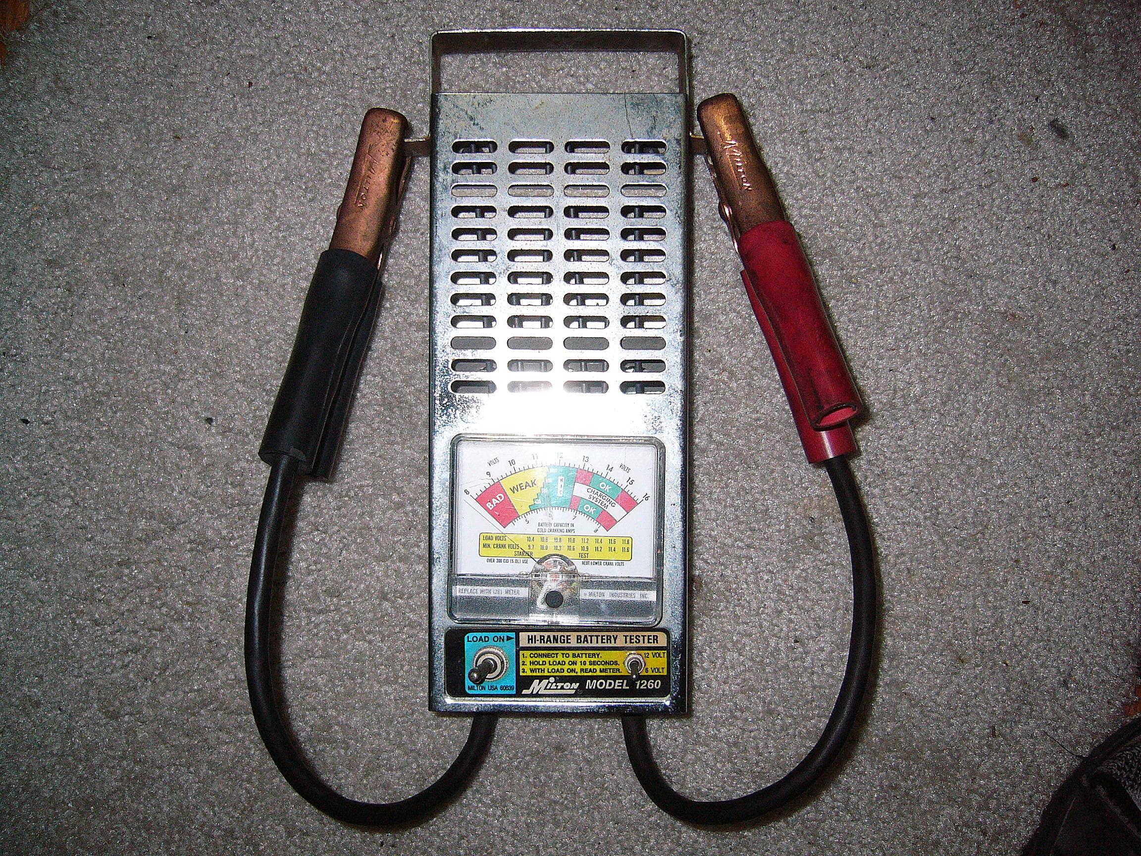

There are several battery test instruments that actually place a test load across the terminals. If you check with an automotive parts supply store in your area, you will probably find something that is affordable, and will provide a quick check to see if a battery is actually storing the charge. A modestly price unit should cost less than $100 US, and will be sufficient for your purpose.
Be sure to try to charge the battery first before you test it.
I bought this tester for about $50 USD, but that was probably 20 years ago.
It has a power resistor within the upper vent cage. You can feel the heat when the battery current flows through it.
It has a switch, so that you can also test 6 volt batteries under load.

Or you could just buy power resistors and test it under load with a multimeter.
