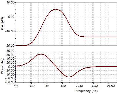

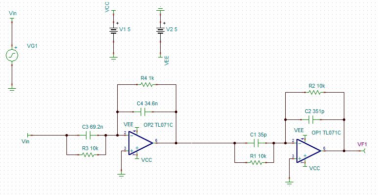

I am designing a passband filter using a high and low pass filters. When I model it using Tina8 with ideal op amps the filter works beautifully as it should.
Whenever I put in real op amps I get some irregularities. It spikes at the end then the output gain is off. I have searched and searched but cannot find out why.
I believe it is possibly Harmonic Distortion but am not 100% sure.
I have attached both what I wish it to look like, what it does look like and my circuit.
If anyone could give me a hand recognising the problem I would greatly appretiate it.
Thanks you

I may be barking up the wrong tree but the first thing I would suspect is an unsimulated feedback path. Layout would be the primary suspect and a lack of bypass capacitors on the power supply or at least the opamp power input leads would be my next concern. It looks like you have a positive feedback path operating around 700K that may even need some interstage shielding.
Harmonic distortion is not likely to be causing the problem.
I suspect the gain-bandwidth of the op amps may also be contributing. Rerun your simulations with an op amp with a GBW (Unity gain bandwidth) of 4MHz as the TL071C has.

Hello,
What is your input signal level? Did you check to see that are within the common mode input range of the op amps?
