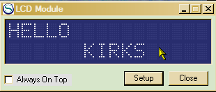

AAesp01..gifView attachment FG_Comb1..asm
hi 2030,
I combined the includes into the main file, Oshonsoft dosn't handle Includes.
It assembles and runs OK.
View attachment 41062View attachment 41063
Thanks Eric, I used your code (thankyou for taking the time to construct the file) to identify where the interrupt should go and where the includes needed to go and it now works... again thankyou.
