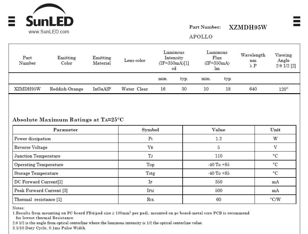

Since I didn't get "half" of the brightness, I Thought maybe it was a non-linear brightness for power, but according to the SunLED Apollo PDF, this chart shows that I really should be getting about 1/2 the brightness for half the current through these LEDs...

The SunLED Apollo chips are PLCC-4 and require the cathode/anode to be heatsinked... basically they rely on a metal core board, but if you don't have that, you have to find a slug of coppy to mount them on, and then electrically isolate that from a bigger heatsink. Hence the pink sil pads... it was a challenge to solder them on. I had to seperate the copper slugs (made from copper tubing flattened and sanded) from the aluminum heatsink, otherwise I would have never been able to solder anything onto the copper slugs.

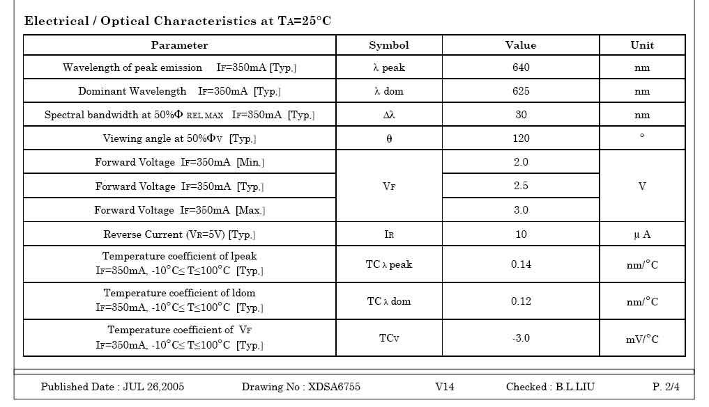

The SunLED Apollo chip is a 2.5v Vf at 350mA... So 4 in series is 10v Vf-total. And 3v for the LM317. I measured 14.5v at the battery with the motorcycle engine running, so I should be ok, no? I measured the voltage drop across the LEDs, and they are almost always 2.3-2.4v on spot...
I think my problem is that the LM317 is only rated for 1.5amps... Am I overpowering this chip? I figured I was using 700mA for the LEDs, and maybe some overhead for the internal resistance of the chip, but still under 1.5mA?

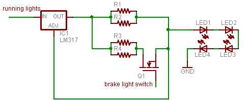

Ocelaris, here's a suggestion for your dual-brightness setup.
Instead of two regulators, use one regulator and a transistor on the current-sense resistors ... one set of resistors is always inline with the load, providing the basic 'running light' current to the leds. a second set of resistors is connected in parallel to the first via a transistor (probably mosfet to avoid voltage drop?). when the second set of resistors are in parallel with the first, the current limit from the regulator is increased.
here's the diagram:
The advantage of that would be less wasted power? simplicity? I suppose I wouldn't have to heatsink the mosfet because it is only providing a very small amount of feedback current to the adjustment pin?
How would I calculate what R2 should be? Since the total sense resistor is the parallel calcuation:
(Rparallel = 1/((1/R1)+(1/R2)...) )
So say [let me consult my handy dandy LM317 chart]
If I wanted to end up with 1.25 ohms for 1000mA current, I would have normally the R1 = 2 ohm = 620mA,
Then to get a total 1.25 ohm in parallel I would use a 3.5 ohm (roughly) to get the total R1+R2 in parallel = 1.25 = 1000mA Correct?
And for R3 I would use whatever the Hfe of the mosfet is, to make sure the current of the gate is say 100mA when the brake light switch hits 12volts ?
I'm glad you brought this up, because I'm just starting to use transistors in a meaningful way, but I have no idea how to select a particular transistor. Do I just calculate what my Hfe needs to be, based on my current requirements for that particular transistor?
Like you picked a Mosfet because the input because I have to assume the Source to Drain has no voltage drop? Or because the gate has an almost infinite impedence so there is no current drawn? I know this is a lengthy subject, so don't feel compelled to elaborate more than necessary. But I do sincerely appreciate the help. I sort of summed this project in a new thread, that I basically am sharing with hidplanet.com members. I sort of eluded to thanking you in the beginning of the thread, because I know you had helped in a few threads of mine.
https://www.electro-tech-online.com...brightness-leds-and-thermal-management.26364/
Thanks as always! Best, Bill
You're confusing your transistors, that isn't a MOSFET, it's a BJT and yes you do need to select an approprietly sized resistor.
I think a mosfet would be better suited here so the voltage drop of a bipolar doesn't affect the feedback to the regulator.
choose a modern fet with a low RdsON ... something like 50mOhms should be pretty easy to find and cheap. At one amp, you'll drop 50mV across the mosfet, hardly enough to effect the feedback to the IC. same goes for heatsinking, which shouldn't be required.
easiest thing I can think of for figuring the resistors is this:
choose what resistance for full brightness ... 1.25v / 1a = 1.25 ohms. (four 4.7 ohm resistors in parallel is close enough)... and presto matho there is the answer. the first two resistors would give you 2.35 ohms, for roughly 530 mA of current. use the transistor to switch in the second set for the full amp of current.
if you use a nfet transistor, it should be on the opposite side of the resistor (the low side)
updated schematic attached
