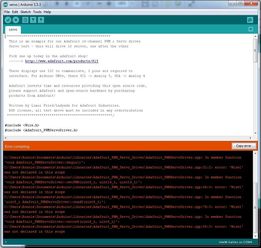

I am having difficulties with using the Adafruit library with the Galileo board. The example code that they have provided should work, but there are errors for days, mainly with a wire1 variable from Wire.h. I am using the Adafruit 16 channel 12 bit PWM driver, because I will ultimately need to use more than 10 servo motors. I have attached the Adafruit library to the post.

and i can look into your problem but I dont understand what do you mean by this
"The example code that they have provided should work, but there are errors for days, mainly with a wire1 variable from Wire.h"
Arduino what?
From the looks of the compile, your using the DUE or the 2560, or some dyxlyexic combo like 2650.
The IDE's are totally different and should contain the Wire1 library.
Your missing the Wire1 library and therefore I'm suspecting the wrong IDE.
Apologies for the super late reply. Some exams got in the way...
The problem with the Galileo board I figured out...it is still using the Arduino IDE that is in Beta phase, so there are a bit of incompatibilities, even if you include all the correct libraries and define and use all the variables correctly. This is what I meant about the wire1 variable in the Wire.h library.
I also tried the servo code to not write is correctly, but with the for loops - thanks, they do work better.
@KeepItSimpleStupid I am using the Intel Galileo Board, which is a Arduino clone.
