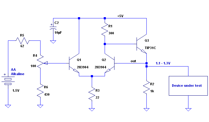

Will this help? It's quick and dirty, and a short to GND on the output will destroy the TIP31, but it is short-term stable, and has good source and load regulation.

Diodes are a bad idea as they'll ruin the regulator's good regulation. The voltage can be reduced all the way down to 0V by adding an op-amp and a few resistors.
