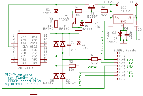

I used this scheme

I used this scheme ............
Instead you may use one attached below, a design by DL4YHF
However JDMs are are poor in design. For long term use, the best is to go for USB based PICKIT2 or a clone with added facilities like tutor for one of the PIC chips. slowly the com ports and LPT ports disappear as laptops takeover desktop PCs.
