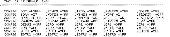

I know, not a contribution to the Winch's (solved) problem but wondering why they use such an obscure way to express the settings...
In my case (working in Assembly), I find the following much more, if not intuitive, explicit:

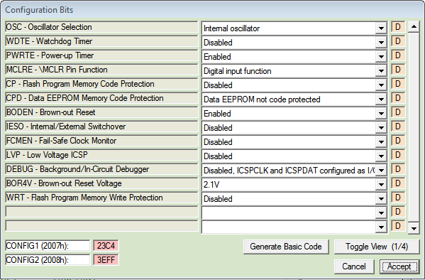

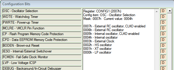

Even more explicit in Oshonsoft...........
Clicking on a "D" gives a description of the config........
Finally clicking on "Generate Basic Code" generates the code and places it in the start area of the BASIC listing.
E.g. (with my comments underneath).
Dave
