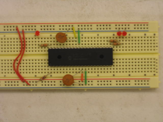

Hi all,
I'm a mechanical engineering student, but I need to build a small and simple controler for my project. I'm been asking around, and I finally ended up with the 16F877A. (It's a long story, but I don't want to waste you time).
So
- Chip 16F877A
- PicBasic Pro
To get started, I just one to write a program for this chip that blink a LED using Picbasic Pro.
This is what I wrote (with the help from friend)
'blinking led
define ocs 20
CMCON=7
ADCON1=14
TRISB=%00000000
'declare vars
led_1 Var PORTB.7
'o
main:
HIGH led_1
PAUSE 1000
LOW led_1
PAUSE 1000
GOTO main
I don't know why it's not working.
Please help me.
Thanks a million.
1)Check the fuses. WDT should be off.
2)Check for the crystal setting. choose HS if you are using crystals above 4 MHz.
3)Check the hardware. Check the LED connections.
4)Post your schematic
I use MicroCode Studio - Pic Basic Pro; not sure the version.
My programer is a DIY - K150.
I've been using these to work with 16F88 for a year. It works fine.
WDT is off
Oscillator is HS
However, before programing, this is what I notice
ROM = Not erased
EEPROM = Erased
ID = Erased
Fuse = Not Erased
is that normal ?
In the circuit, I setup two more leds at two different ports to try instead of PortB.7; nothing lights up :(
Before, I didn't need any crystal for my 16F88; I just needed these two lines
define ocs 8
osccon.4=1 : osccon.5=1 : osccon.6=1
I thought this would do for the 16F877A.
Ok, I'll put the crystal in, and report the problem.
Thanks for your help.
