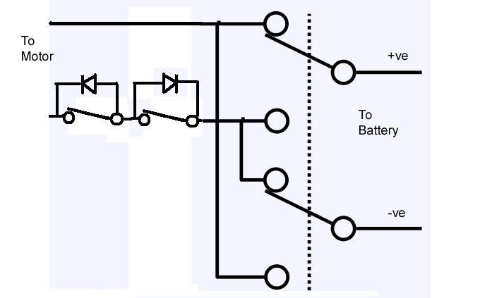

If you use a double pole switch in a changeover configuration you can put the limit switches in the crossed wires.
Found an image on wiki, **broken link removed**
Put the (normally closed) limit switches in the two vertical connections.

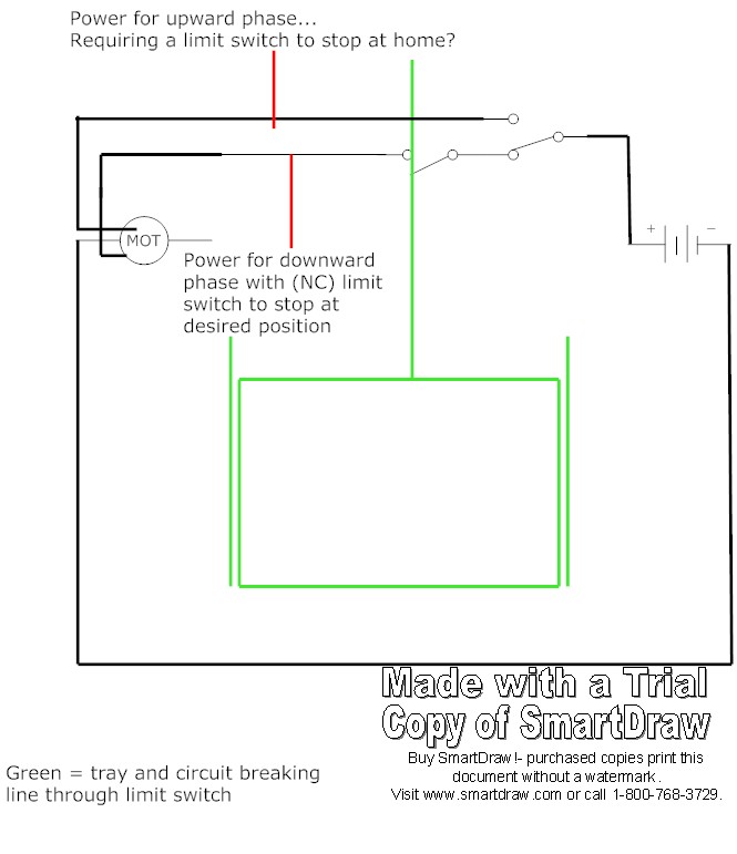

The main problem I've been having (despite numerous googles) is working out exactly how DPDT switches work, however while I was writing a post explaining my whole situation I think I might have come up with a semi-viable solution!
What do you think of this:
What you have is similar to the change over switch idea. A change over switch is simply two switches in one.
The dotted line in the diagram just represents the fact that both switches are joined and switch together. Can you see how the polarity to the motor is reversed by the switch?
Edit, Changed the diagram. Should work now. With the DPDT switch in the up position the motor will run until the left limit switch opens. In the down position it will run in the opposite direction until the right limit switch opens.
I can see the reverse in polarity but now it's combining it with the limit switches that's confusing!
Say the top wire was for the upward direction of the tray and the second from the top was downward, how would you set up that first limit switch so it stops the motor when the tray reaches home?
Edit:
Disregard that, I just had a look at your diagram again and it makes more sense now! Thanks! :) I'll try and plan this out a bit further and test it out ASAP!

We posted together, see it the new diagram makes more sense. I'm assuming that the motor is a small DC motor that is reversed by changing the polarity.
I'm still trying to choose a motor I think would be appropriate... During my searching I've found mention that geared motors can sustain weight while not powered or something, which is appealing, but mostly I was looking at reversible DC motors since I read that reversing the polarity of a regular motor can damage it?
What's your opinion on this? And should that circuit still work with a reversible motor?
That circuit will only work with a reversible DC motor. I'm assuming you will by using something like a small model type geared motor. You would definitely need a geared motor so you have enough torque. Geared motors keep their position simply through friction in the gear box, especially worm gear motors.
