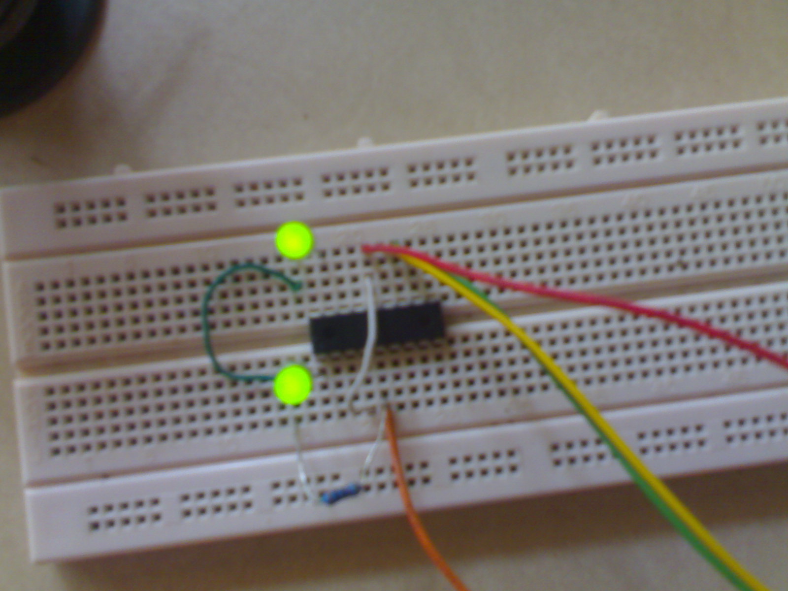

Those were the codes i used in my PIC16F628A. I have connected the power supply of 5V,2A directly to the PIC as 5V is an ideal voltage. Then i connect the RA0, RA1 and RA2 to 3 leds (Directly connected to the pins without any resistors). However my led is not lighting up. Does anyone know why?

You need to add a resistor with the LED's. You should also connect MCLR to +5v.
The debugging problem I can't help you with, since I don't have a PICKIT 2.
There is your prove that the code works.

Its simple. You defined it that way.
__config _INTRC_OSC_NOCLKOUT & _PWRTE_ON & _BODEN_ON & _MCLRE_ON & _WDT_OFF & _CP_OFF
If you don't want to connect mclr to +5v, or use it as a input then it should be like this:
__config _INTRC_OSC_NOCLKOUT & _PWRTE_ON & _BODEN_ON & _MCLRE_OFF & _WDT_OFF & _CP_OFF
Edit: I use anything I can find on my table. Between 270 - 1k works fine for me. But you can calculate the value using ohms law. I don't understand the last question.
