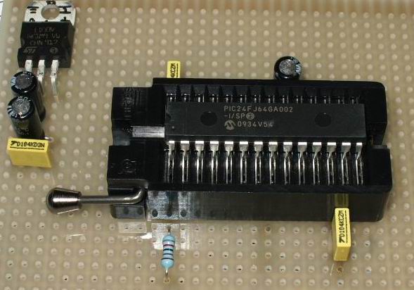

You can program the pic24Fs with the Microchip Pickit2 or as you prefer a diy one, the Pickit2 Lite diy clone featured in this forum.
At first look the diy unit will only do 5v chips, but all thats needed it to cut the usb input 5v rail to the whole circuit and insert a 3v regulator so the Pickit happily programs the pic24s at 3v.
Actually proved this last night with both a proper pk2 and my diy clone.

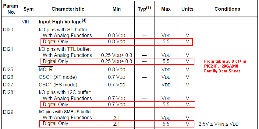

One more small question. If PIC24FJ128GA010 is 3.3V based and another PIC18F4520 is 5V based, will it be possible to connect them both to make them communicate (parallel communication) or will i need to add some buffer in between.
If a buffer is required, will it allow both direction data flow?
If you used the PIC18LF4520 you could run it at 3.3V too.
The PIC24FJ128GA010 has some 5V tolerant, digital only, inputs which could be interfaced directly to 5V logic. You would need to interface these to TTL level pins on the PIC18F4520 if you want to avoid using a buffer chip.
You can get bidirectional buffers.
No, you can only use IO pins which don't have an analog function. ie: You cannot use PORTB because they are capable of analog modes (ADC, comparator, etc) even if you configure them as digital IO. This extract from the datasheet shows that the digital pins will tolerate up to 5.5V but any pin with analog capability can only tolerate up to Vdd (3.3V).
