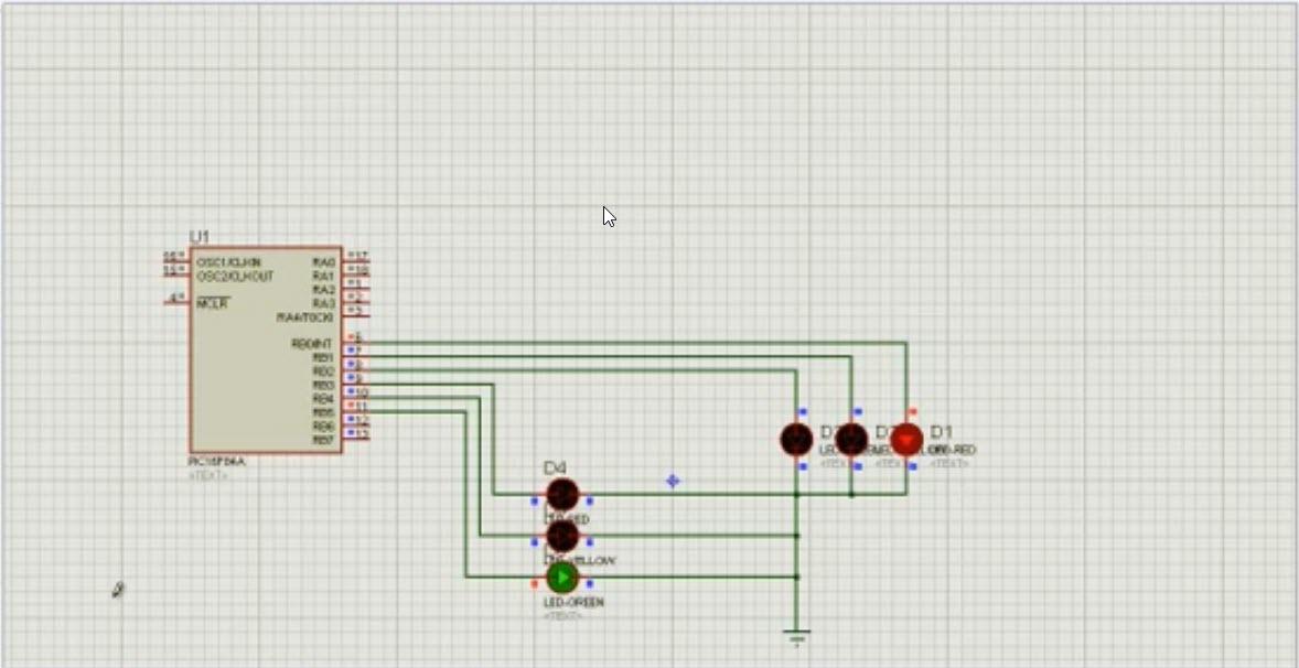

I have 12c508a pic and I'm using proteus to simulate before writing in the pic.

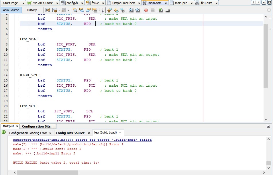

But the second file is open one, but I don't know how to compile it, I've tried mplab, but it didn't work.

SimpleTimer.zip compiles fine for me using MPLab8.92. It should also program, but I did not try to do that.
I did not take the time to simulate or test it.
What errors do you get when you try to program? The 12C508a is a one-time programmable chip. Are you sure that is what you have? Once you write that program to it, there will be no opportunity for changes. Can you get a 12F5xx chip?

Thank you for your reply
I have
MPLAB X IDE v4.01
and I opened a project with pic12c508a
but when I compile, it won't work
The problem I have to use 12c508 a

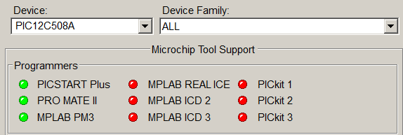

It just occurred to me to check this:
As a Yogi Berra used to say, it was like deja vu all over again. The last time I tried to program a non-flash chip I had to buy a PicStart Plus to do it.

I used MPLab 8.92 . You are apparently using MPLabX 4.0x I do not use that version, but I am pretty sure it generates a hex code too, once you get your code to compile.
First get your code to assemble (compile) in either Release or Debug. Then, assemble (compile) it in release mode. Then, look in the files. You will find several including a .hex file.

Hello again
I have downloded the 8.92v but the code didn't compile for me
I guess the problem is in the code itself

Your program would need some modification to do that, because it uses TRIS to set direction to input, which turns off the outputs. I can modify that, but which pin do you want to be constantly high? So as to avoid confusion, either give the pin number or the GPIO number, but be sure to say which numbering system you use.
What programmer are you using? Depending on what you have, that may be a wasted effort.

Making one light steady on does not simulate any traffic light I have seen in the past 70 years. Please try to answer my questions
