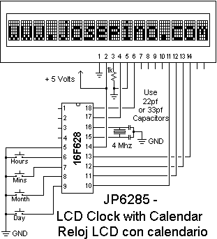

I've build a LCD clock using the schematic attached. The first time I program it using a Inchworm everything programs fine. If I recompile (mplab) and want to reprogram the PIC I keep getting errors. (verification failures)
I've done some fiddling and its to do with the PGM pin being connected to the LCD - if I disconnect the LCD it programs fine.
While this solution is ok I would like to program without disconnecting the pin all the time. I've tried a 10k resistor between the PIC pin10 and the LCD but no luck.
Whats the trick here to get it working?

Is your schematic complete? Add a 0.1uf cap across pins 5 & 14.
PGM can be disabled with a __CONFIG setting. _LVP_OFF also you may need to add _MCLR_OFF since you have no pullup on the MCLR pin.

I've added the cap and the 10k pot - made no difference. The problem is not with the LCD - once programmed everything works 100%. Its when I have to reprogram the PIC in circuit that I need to disconnect pin 10 on the PIC. I'm looking for a way to not have to disconnect the pin every time I want to reprogram it.

If you turn off LVP in the config then there should be no way that the level on B4 should make any difference. Can you post the source file? Or even the hex file.

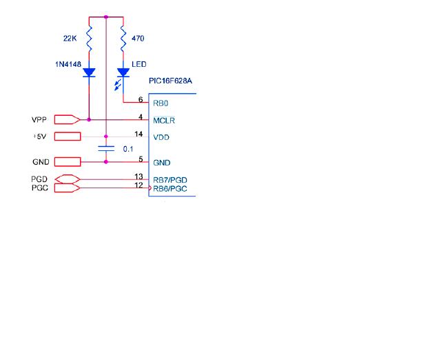

Here's a pic on my ICD2 wiring (its from Bill's hello world project)

When I am using B6,7 in the main circuit I have 1K resistors in the lines from ICD2 to pic. In this circuit I would also put a 10K resistor from the enable pin (RA1) on the LCD to Gnd, this ensures that the LCD cannot become active and interfere with B6,7.
No such luck - I put the 10k to ground and the 1k resistors between the pic and icd2. I've even tried to short lcd enable to ground - it still refuses to be programmed while PGM is connected to the LCD.
The ICD2 (and Inchworm) both have 4.7K resistors to GND on the PGC & PGD pins. As long as the __CONFIG _LVP_OFF is there PGM should make zero difference.

Greg,
You say it programs OK when you physically disconnect PIC pin #10 from the LCD???
As a test keep pin#10 connected as normal, start the program sequence and measure what voltage level is actually on pin #10 throughout the sequence, voltmeter or scope would do it.
Lets know what voltage level you see on this pin.

Eric - I've put a scope on pin 10 - its a constant 5V throughout the programming. I guess this is why it keeps failing. Dunno why I didnt think of doing this before! I've now put a 10k from pin 10 to ground and its working!!! Wooo hoo!! :)
