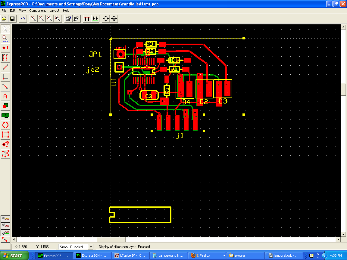

After a brief discussion, I think we will go the POGO pad route and program in circuit. These are low volume units (500/yr max). Are there standards for POGO setups? I would rather not install a pin header for programming.

Thanks! The programming will be a one shot deal. it will all be potted after. Just looking for the easiest solution to program the chip for smaller production runs. In circuit is likely to be best but if there are fast programming sockets so we can program before installing, that is fine too. I guess that is the basis for my questions. "fastest way to get low productions chip programmed" I am having a hard time finding much for surface mount components. Not sure if most of them are pre-programmed or what. I might be fine to use an adapter for our pickit to mount the (now) SOIC chip. We were going to use the SSOP but found it will likely be a large challenge to solder. VERY small guy...

Just design the pc board w/ edge card contacts
This is what I am in process of doing.
Use a 6 pos female edge card contacts on an adapter board so the Pickit2 can be connected.
Then its just a matter of pluging the pc board into the female edge card socket.
attached is circuit board I am working on. It uses 5 contacts as I am using a Junebug, not a Pickit2.
here is a picture of what I am using. the short ones have 9 pos. I need to increase my edge card contacts but I got about 100 for free so beggers can't be choosie. Going this method allods lower profile
