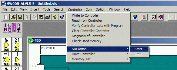

Alpha is programmed in FBD and you can enter code using the buttons on front of the unit. Unfortunatelly this is very difficult unless you have cretaed and tested logic in software (Mitsubishi software has simulate mode). Programming cable for Alpha was almost as expencive as the device itself but it is way easier to do. Programming port is under blue plastic cover on the left side. It is a tiny white connector with 4 or 5 pins (don't remember anymore, didn't see it in ages....).

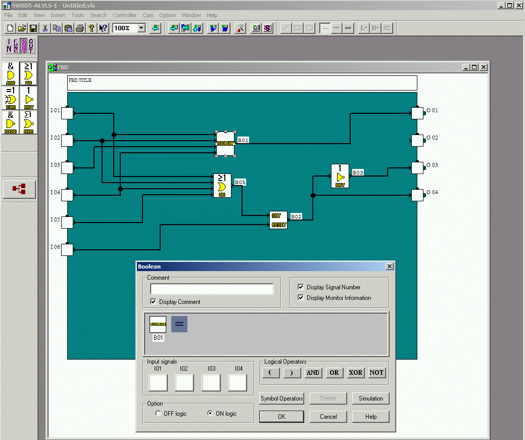

here is a sample logic for your controller.
just drop blocks you want, tie them together, tie inputs and outputs

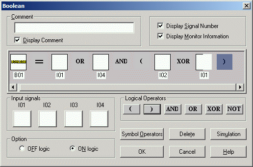

and configure blocks that are not fixed (there is nothing you can change on inverter for example, except comment). I clicked on Boolean block
and you can see dialog to configure it. You can create logic inside the block using provided operators. I think this is selfexplanatory.

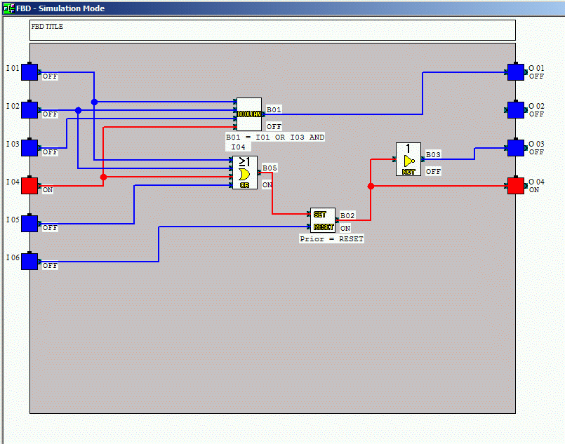

here is more:
