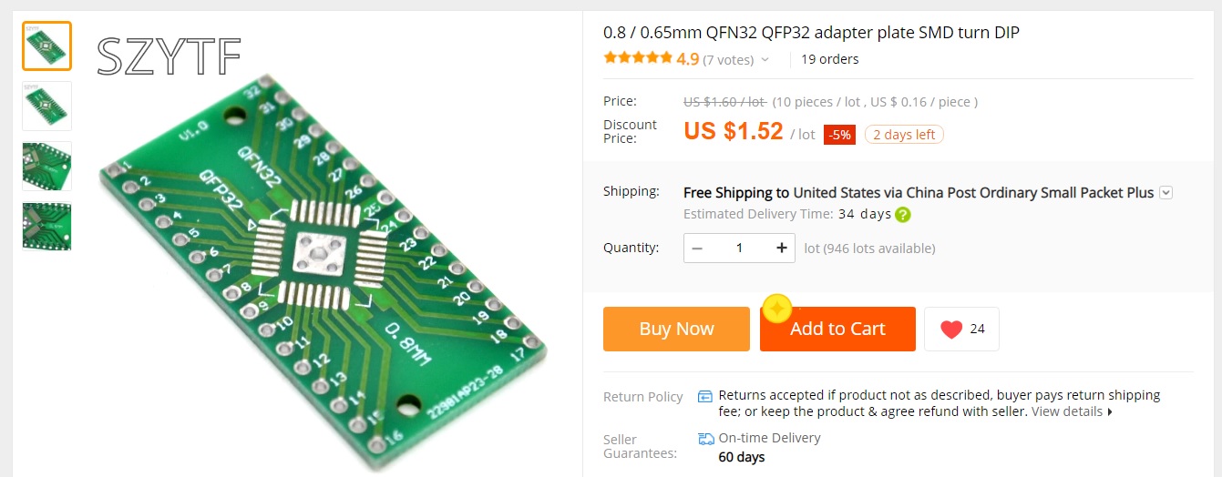

Would anyone with an MKRZERO consider helping me out by burning the bootloader onto some 'D21E samples I've got coming? I've also ordered the adapter boards (see below) which should show up in a few weeks.
Cheerful regards, Mike
