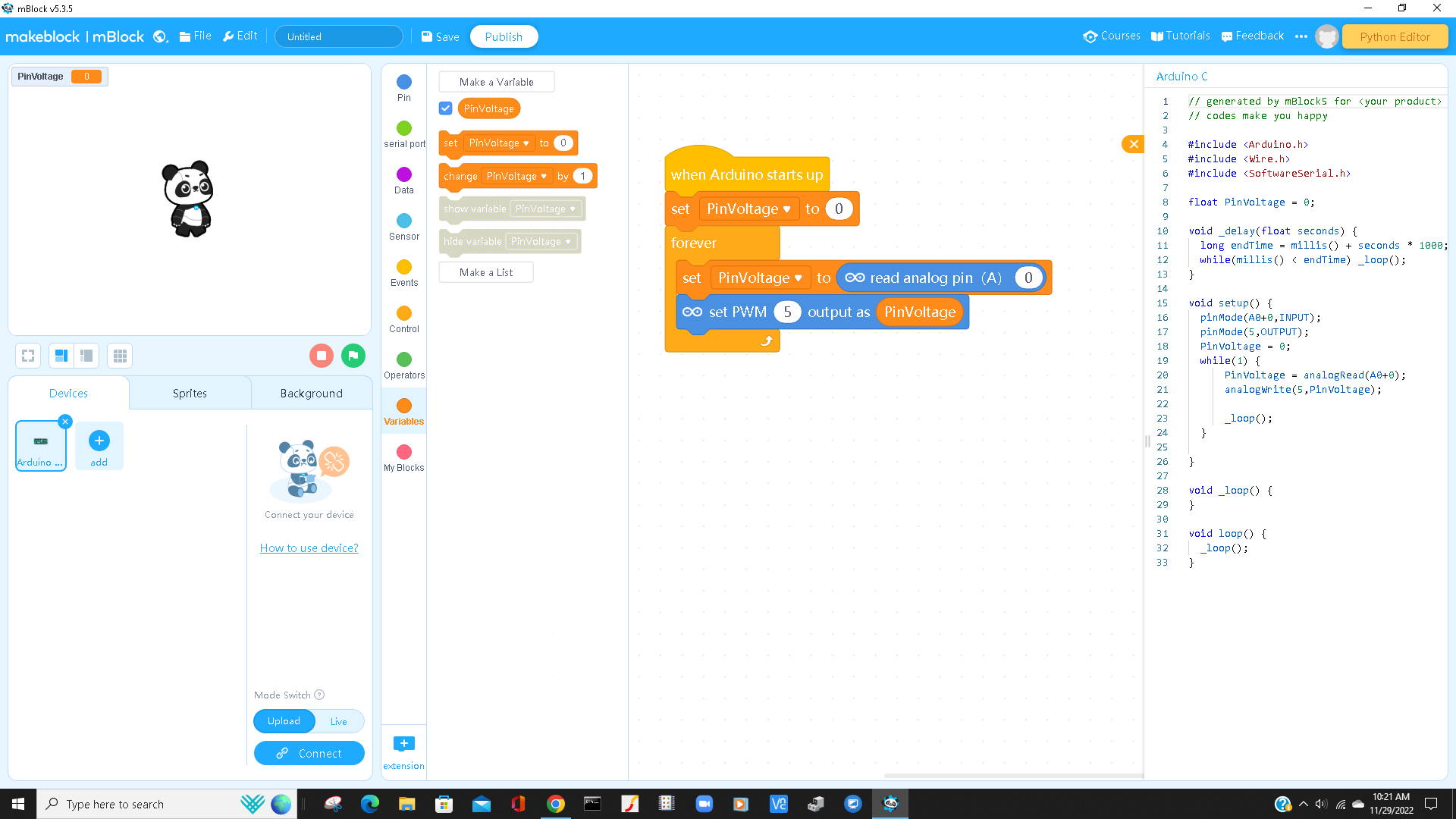

ThanksKids, and now adults for some specific quick turn projects, are using a
visual approach called block language programming. This is where you
drag and drop function blocks, like
The above is a very simple application, read a voltage and set a PWM duty cycle, its pulse width,
proportional to that voltage. Here its trivial to do, the blocks are dragged out of the 2'ond window
from left, and placed in 3'rd window, and configured, like pin number to read, pin number to output
PWM signal on. As you do this mBlock, this particular program, converts the block configuration into
Arduino code (C like code) and programs it. Thats the code you see in right hand window. Kids are using
this in 6'th grades to program robots and their movement. I use it to do fast turn around of simple stuff,
like below link. More complex stuff I do in C.

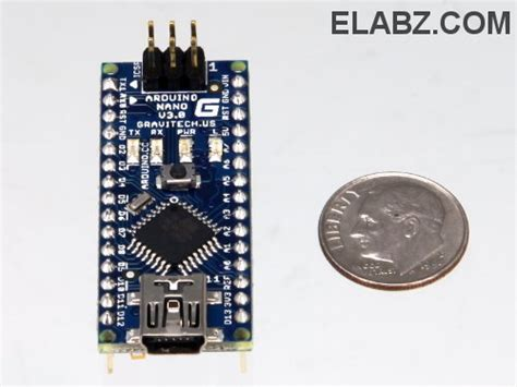

If you start with mBlock or Snap4Arduino, software is free, a low end but capable board ~ $3, Arduino
Nano, and a USB cable will get you started.
