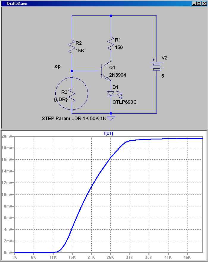

To do a detailed design, I would need to know the resistance curve of the LDR. This shows the idea, but the actual resistor values would depend on your LDR, Battery voltage, and LED. The plot shows LED current vs LDR resistance.

MikeML, I'll feed the LDR to 5V because it is the tension that the LED can stand
The LED doesn't care what the supply voltage is as long as it has the correct current-limiting resistor in series with it. Look at R1 in my circuit. It limits the current to 18mA.

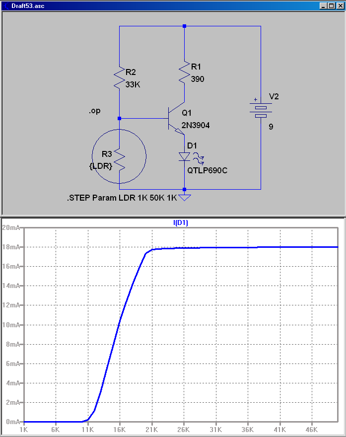

Here is a modified circuit that starts with a supply voltage of 5V. I still need to know the resistance of the LDR when it is in dim light.

Your circuit seemed to me simple and functional, just did not realize where I turn on the lamp! : S
is in D1??
D1 is the Light Emitting Diode (Red is modeled). The plot shows current through the LED (Y axis), which controls its brightness, as a function of LDR resistance (X axis).
