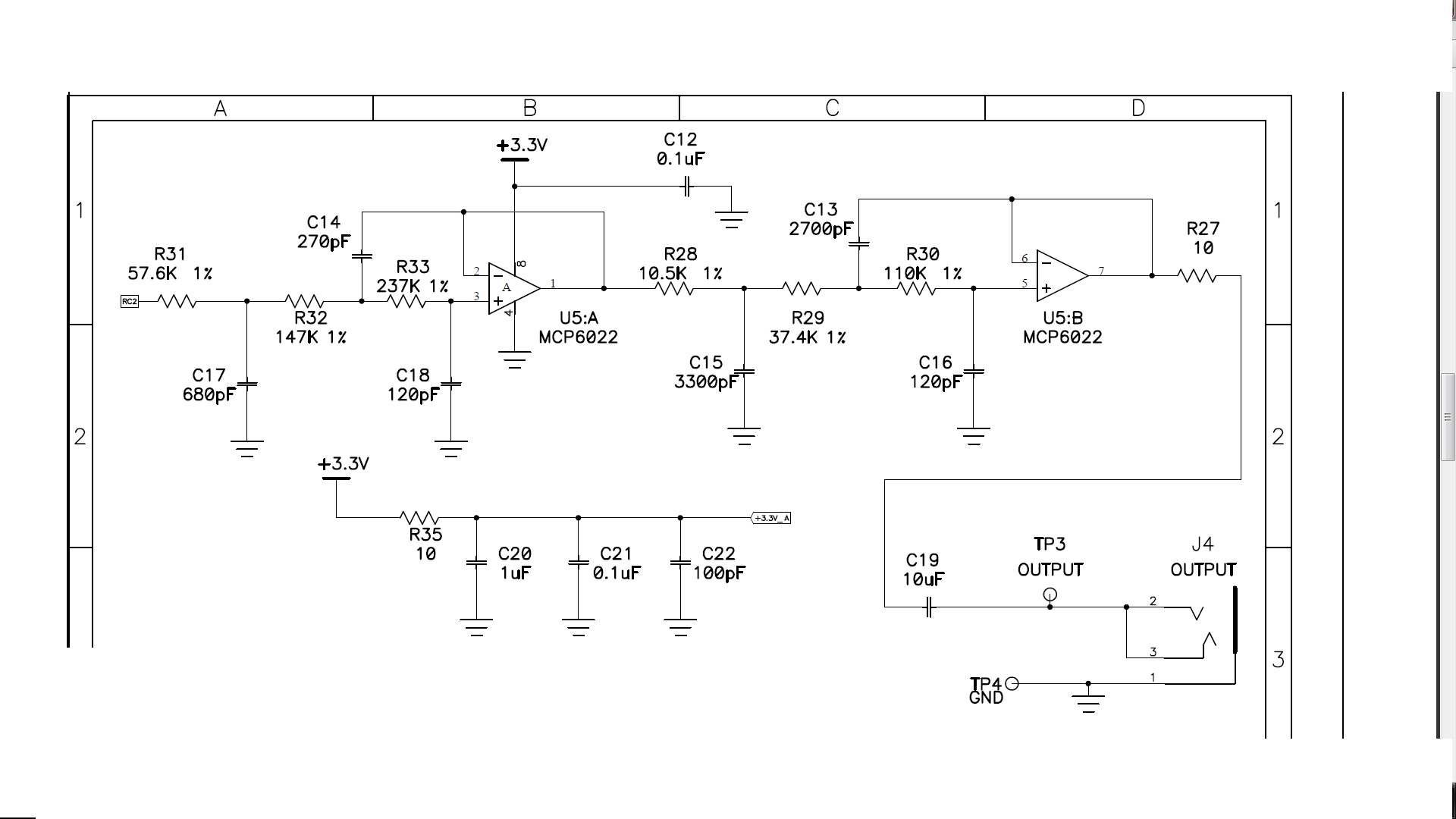

Now I m trying to understand how pwm work. This is my code so far. I m trying to generate PWM and then use rc low pass filter on the the PIC18f46k20 starter kit board to generate sine wave. But the outcome is not close to sine wave. Any help would be appreciate. Thx
