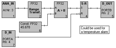

I have been working on an IDE to use function blocks (FB) in a graphical interface and would like to hear from others interested in this kind of thing. Programming is done by 'drawing' the the application using standard FBs. Debugging is done using the PIC and PC serial ports to display live data of the values present on the input/output pins of FBs. The FB library contains around 130 elements - from the humble AND/OR variety to PID controller and I2C Read Write elements. Compliments of Microchips asm, the IDE produces ready-to-burn hex code. As a picture is worth a thousand words.... included is an example of a simple temperature alarm.

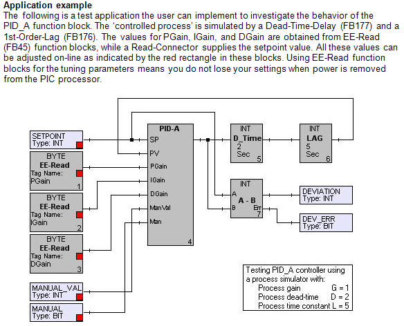

You are right about PIC01_CB (thats what i call it), its is for automation, what most PIC's do (?). PIC01_CB provide all the things you mention. It will take to much typing to explain all, but the PIC software execute function blocks under a cooperative multi tasker (more correct a task manager) with 'time tasks'. With the IDE you assign a graphics page to a task. The IDE will automatically adjust PID time settings to cater for different execution times. There are also function blocks for integrators, rate limiters and pulsers that need their execution to be time regulated, and all being taken care of automatically, or should i say without you having to worry about it. I include a clip of the PID block documentation which you might find interesting. Lots more documentation is available on PIC01_CB for those interested.
In "serious" control applications I need to worry about things like that. I need to know is the algorithm executed often enough, and how much delay there is between input read and output update.. and what are the integrator limits and can I set them manually? And is the derivative calculated from error signal or is there a more stable algorithm in use. Knowing the PID update frequency is crucial in order to tune the PID parameters correctly.
If PIC01_CB provides that kind of flexibility then I consider it to be potentially very useful. Otherwise it is only good for very simple things.

I probably used the expression 'dont worry' wrongly. Anyway in PIC01_CB the PID execution rate is known; 10, 20 40, 50, 100 or 200mSec. Input can come from a AI or other function block and output can go to another (say a cascade controller) function block or drive the PWM function block. The integer term is limited (for windup) and the integer (I-gain term) you can change to suit loop parameters. Same goes for the P and D terms. The derivative calculation is not based on the usual 3-point differencing method where a 2nd degree polynomial approximation is used. The method i used is more related to a least-squares approach, and much simpler! The attached is an example of the documentation for PIC01_CB function blocks and will explain the derivative algorithm, which uses the error signal to calculate. I plan to later include an option to use PV for this calculation. Also in the pipeline in a controller using the velocity algorithm, then you realy dont need to worry about those integral limits!

Sounds great and looks great, but let the user choose the integrator limit (it is important factor in PID control). Good documentation is the key to successful product.. so keep documenting all the details.

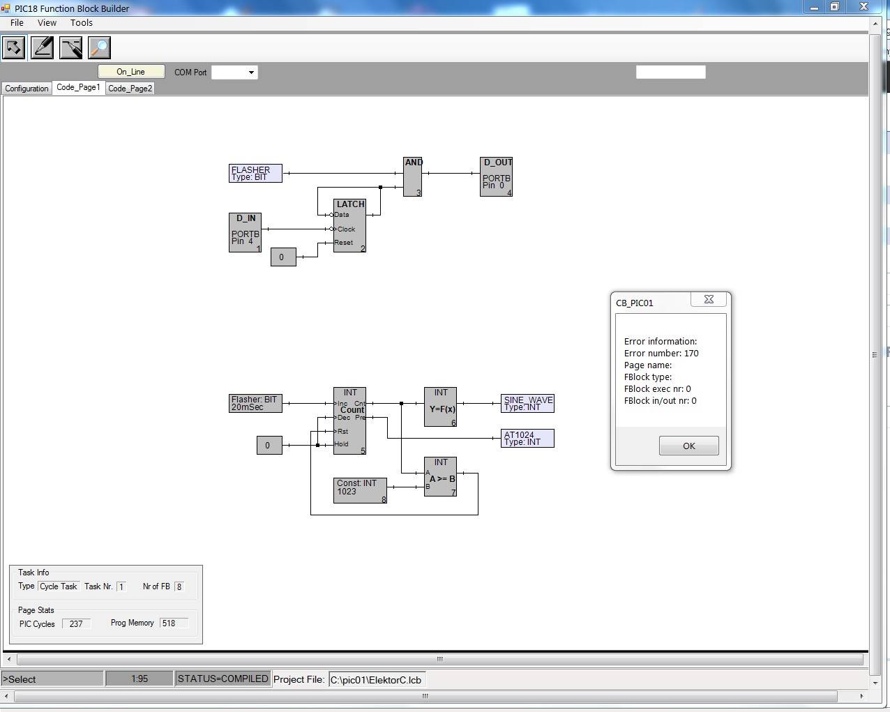

Hi Steffen
Error 170 means: Macro library directory not found. Should be in C:\LLG_CB.
MPASMWIN v3.35 is OK, but pic_cb require that you have MPLAB installed (any version from 7.3 to 8.50) because it uses, in addition to the assembler, the pic-include files.
I suggest you send me a Private Message with your e-mail address so i can send you the install file for version 1.31. This will instal pic_cb and all current documentation (which include an Error Code List) in the required directories.
Lourens
