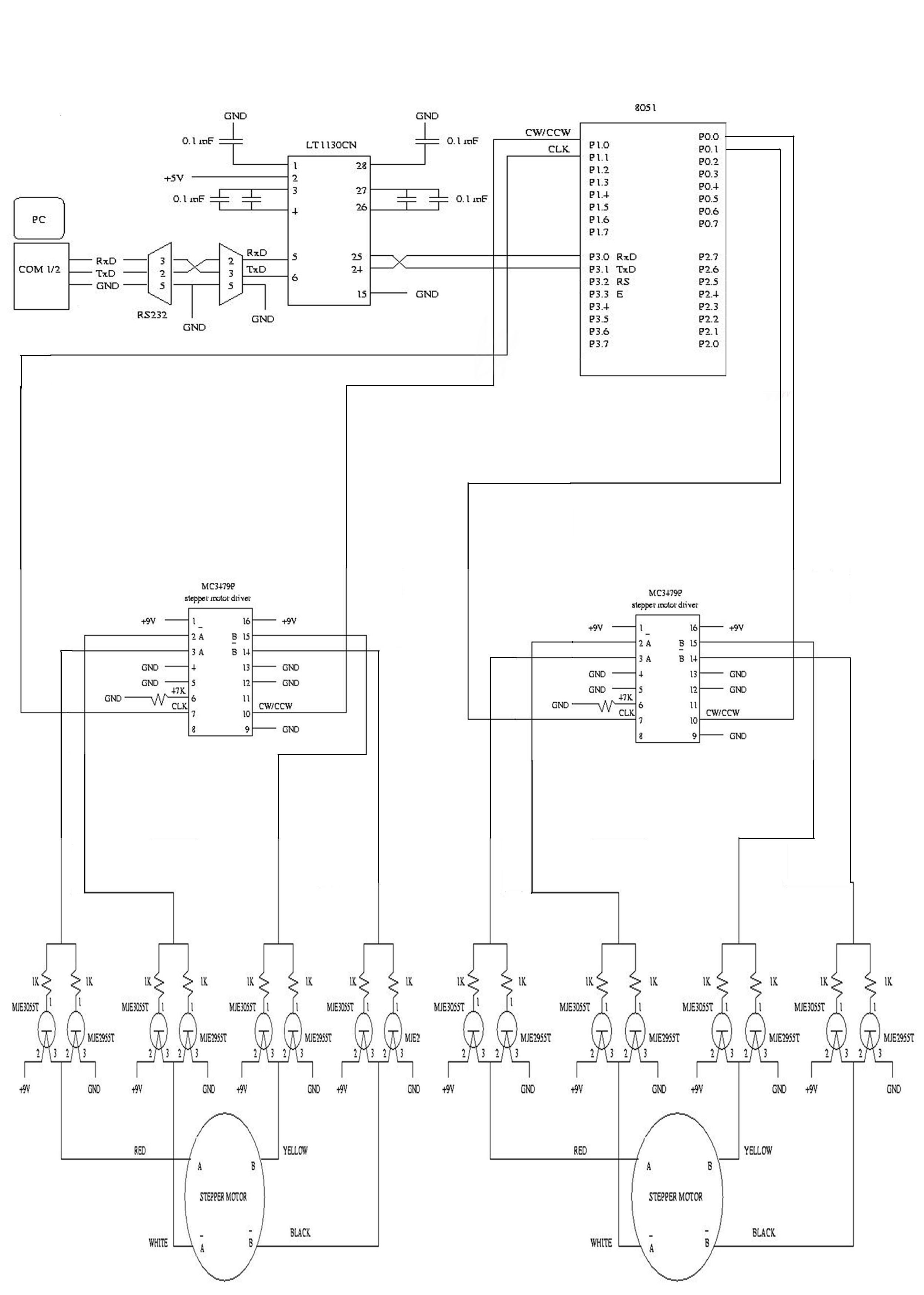

can anyone help me to pogram the below shown circuit in keil.i am trying to program it but i am facing the problem in timer commands. i want the circuit to transverse for some distance and later turn its direction and again transverse. i am controlling the motion from a PC
