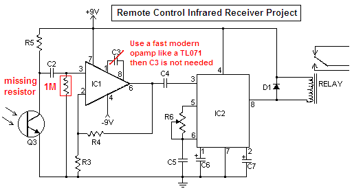

Electronics-lab website is down right now.
Is the IR circuit the one from Aaron Cake's site?
It is missing an important resistor in its receiver. Also its opamp is obsolete.

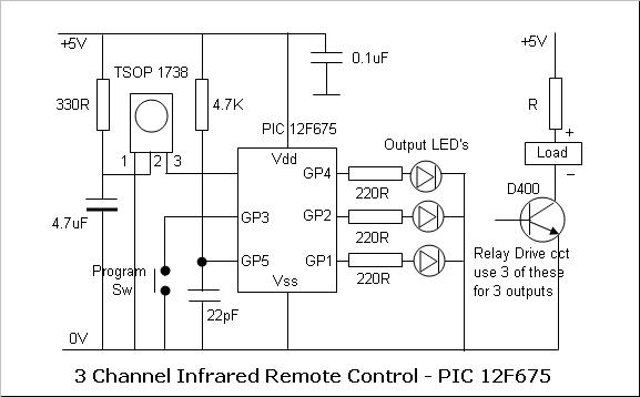

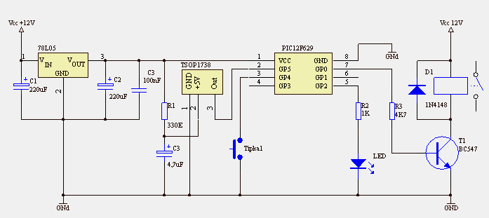

a project use pic12f629
look in line 154 (CALL LADR_0x03FF) ,I don't understand ,where 0x3ff in program:confused: :confused:

How come that your asm file shows 16F chip while the original chip is 12F629?
perhaps you tried to disassemble on a programmer driver and forgot to change the chip to 12f629
please try again. this error would go off

Well, address 0x3FF is the last word of the programming memory inside the 12F629.
Microchip has placed a magical value inside that memory location for user to load into the PIC "OSCCAL" register so that the internal RC oscillator will then oscillate at the stated accuracy. All the user need to do to get that value is to simply CALL that memory location and W will contain the value afterwards.
This is documented in section 9.2.5 of the 12F629 datasheet.
Some *good* hardware programmer will go into the trouble of saving this value for you every time while erasing the chip and store it back afterwards. In most cases, the user will never know this value exists.

Thanks L.Chung
I missed this info. Thanks and I stand corrected.
P S: I don't know how far I am correct, I modded the line 154as below
CALL 0X03FF
then, tried to assemble thinking that the address oxo3ff is not a predefined location by the software, but a feature of 12f629. it was successful. I am not much into software as still learning. could this approach be correct Please?
