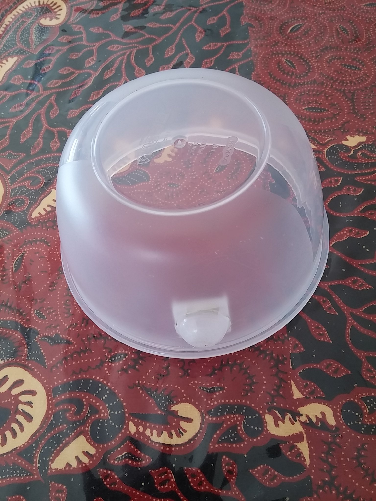

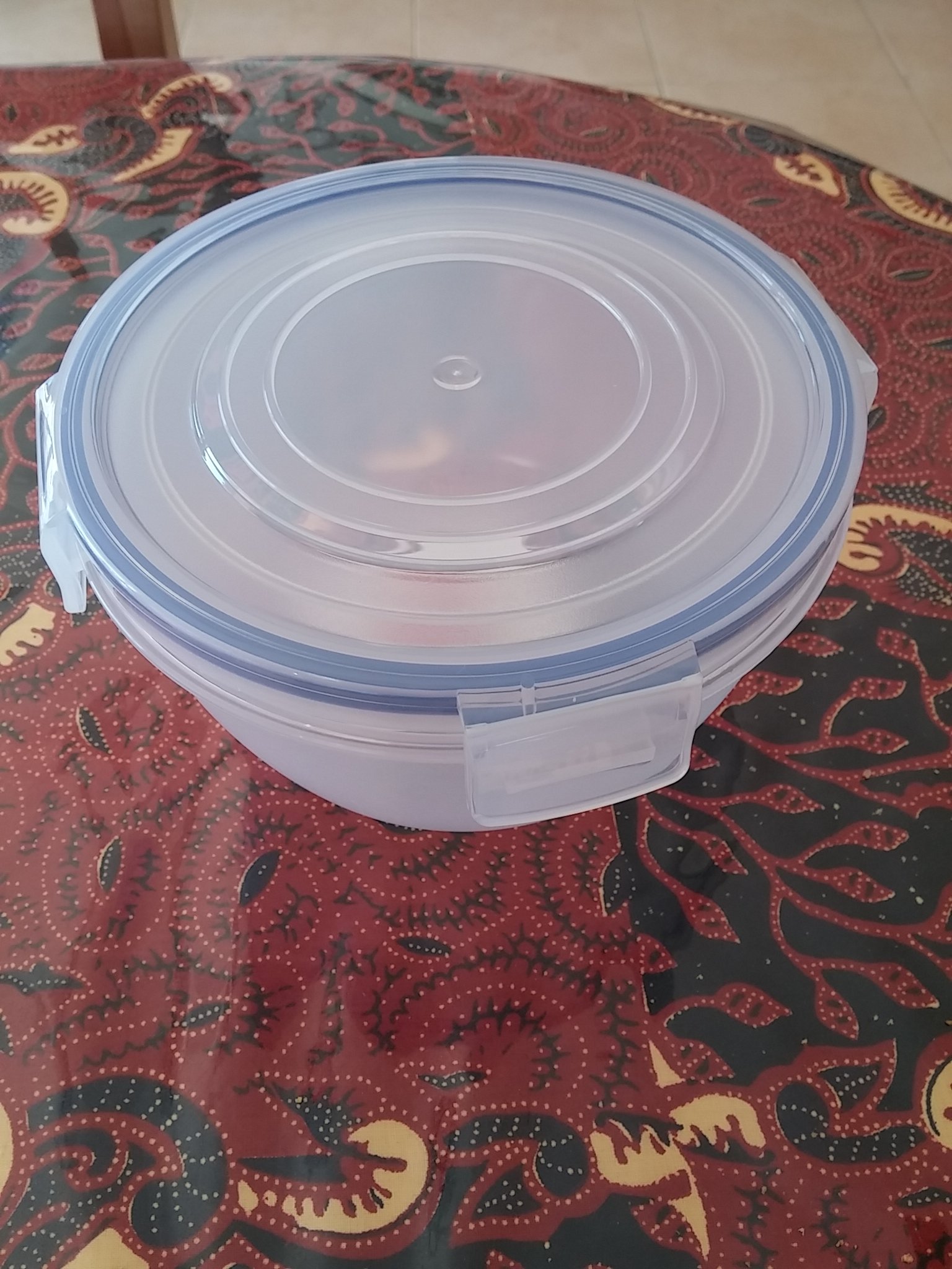

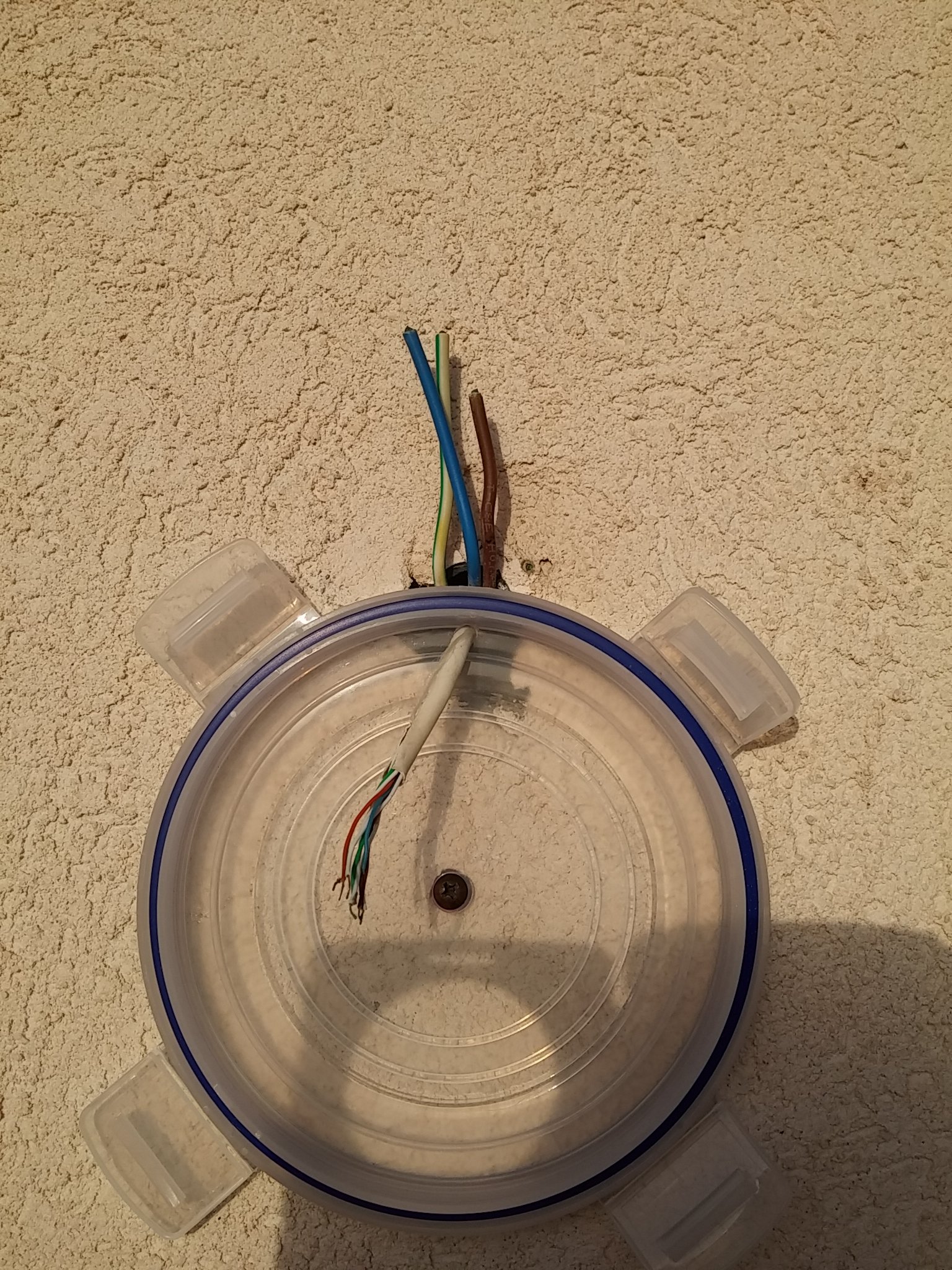

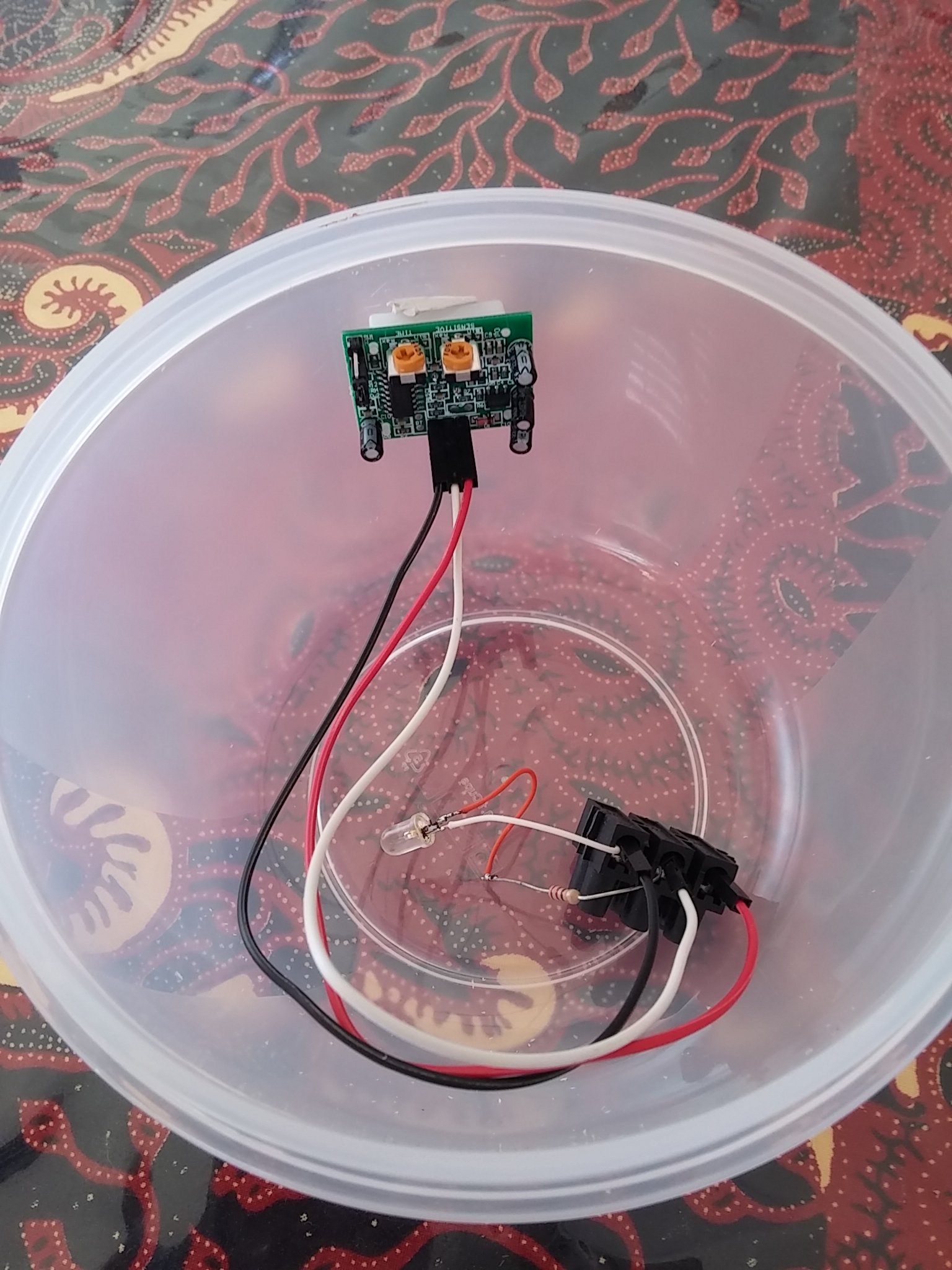

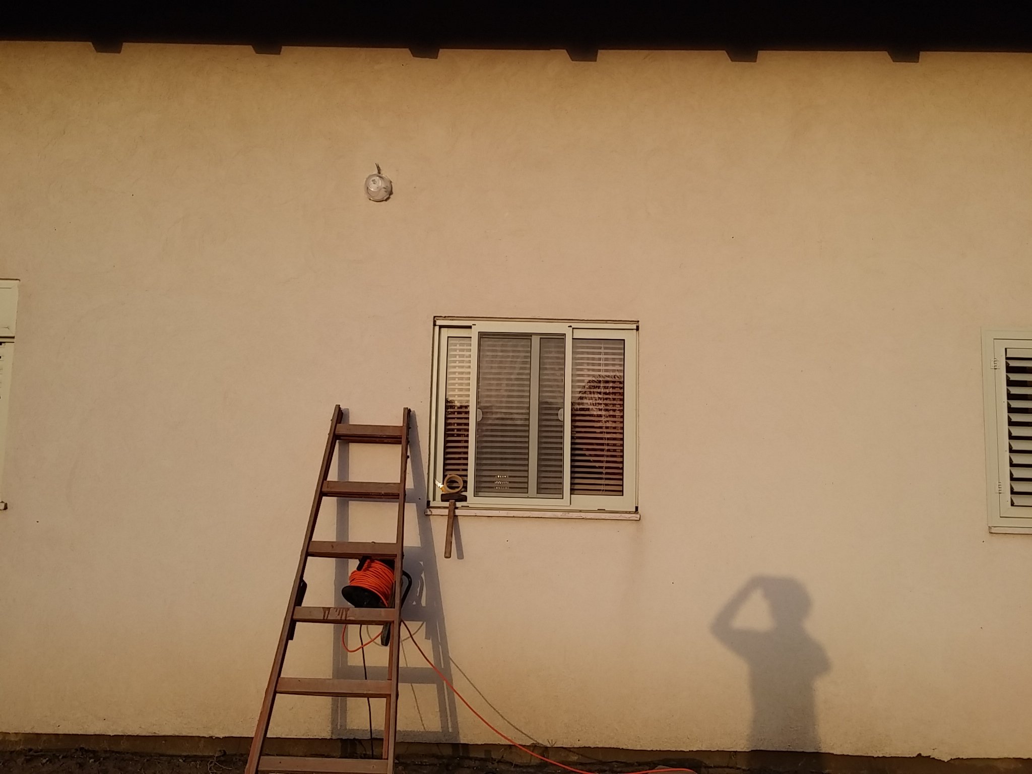

I forgot to mention, the PIRs will be bundled 3 in a a round plastic box -will post picture later- in the middle of the external walls, each directed to another of the 3 windows of each wall. Each bundle will be connected via 8 conductor phone cable to an inhouse board managed by an arduino. As for the presence detection, since the PIRs operate at 3.3V using an LDO and the arduino uses 5V I should be able to sense the presence without using an extra wire:
2 will be used for the power
3 for the info: i'd rather nor OR it to have a better follow up on what's going on
3 reserved for the moment

For the covering detection system, pulsing an IR emitter directed to one of the three sensors means i have to stick it somewhere on the wall and to power it (preferably with the same controller so it can test the receiver while powering the transmitter) but i made no provision for such a transmitter. I was wandering if i could use a sonic transceiver placed inside the plastic box which would detect if the box is being covered by an object, even a cloth.
As promised, here are the pictures
20150419_161542.jpg 20150419_161705.jpg 20150419_161717.jpg 20150419_161728.jpg 20150419_161821.jpg 20150419_182137.jpg 20150419_184016.jpg
