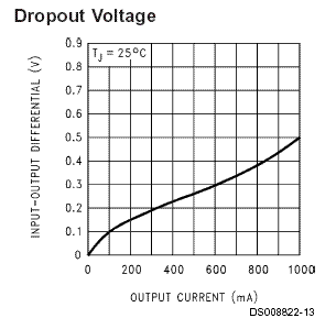

See the attachment, the dropout voltage is increased if the load current is increased, and maximum up to 0.5 V only. You're just running LEDs right? So the current drawn is not that high.

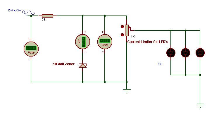

Here's a simple solution, use a zener diode, you'll have to play around with the circuit to suit your application (as the resistances/current requirements would be different).
I tried to make the circuit as generic as possible - it might just suit your app straight away?
Here is a video simulation of the circuit

gramo - Your zener diode circuit has me interested, yet scratching my head. I don't understand how it works. I had though about a way to use a zener, but couldn't figure out how, or if it was even possible. I'm gonna sleep on it and look at it more tomarrow.
Put simply I guess, the zener will try its best too change its resistance to keep its rated voltage. That said, you need to keep a few things in mind, mainly nominal current and maximum power ratings of your zener.
Designing a circuit that is protected by a zener can be a little mind boggling, but just remember that the current limiting resistor is going to act like a voltage divider with the load. Perhaps this video will explain it more;
Click here to watch the example
I know that I said 90.1 milliohm instead of 90.1 milliamp :p but you get the jist of it
