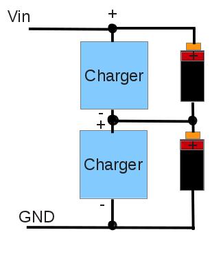

2nd Question: Can I used 2 Chargers In series to charge 2 Batteries in Series? Ie, Wire up One Charger with one battery, and do the same with the 2nd Battery but in series. I do plan on using the batteries in Series (this drill was only 6V or So-Its really old but it worked fine until the batteries died). See attached Diagram. Im only doing this so the cells get balanced when they are charged and so I dont have to get another charging IC.

Here is an example of an Li protection IC: I would not ttry to duplicate it in discrete circuitry, but it's theoretically possible.
https://www.electro-tech-online.com/custompdfs/2011/12/S8200A_E.pdf
You may want to check and see if the Li batteries have a low enough internal impedance to feed a drill's high peak currents. Ni-CD and NI-MH have ultra low ESR, Li batteries are higher when comparing similar size.

Li-Ion battery cells from a laptop will be for low power, not the very high power for a tool. Also, they will not be new so their capacity will be lower than their rating. They might catch on fire when the tool draws its very high current.
