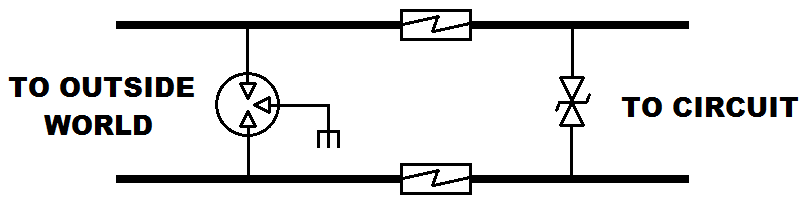

A typical lightning protection circuit includes the following parts:
  • Tripolar gas discharge tubes
    These should be placed across the supply lines closest to where the "outside world" comes in, with the middle terminal connected to earth ground
  • Inductor or other surge protection
    This should be placed on each line just following the gas discharge tube. Inductors (~10uH) are one option. An alternative would be the TBU series of surge suppressors from Bourns, Inc.
  • TVS (transient voltage suppression) diodes
    These will be located as close to your circuit as possible. Make sure their clamping voltage is below the rating of your circuit's components, but make sure its breakdown voltage is high enough that it will not start conducting during normal operation.
Below is a rough MSPaint sketch:
That's about as simple as you can get while maintaining reliability.

My god DGT are small. I never they were available in such small sizes. I always envisioned something the size of a vacuum tube.
