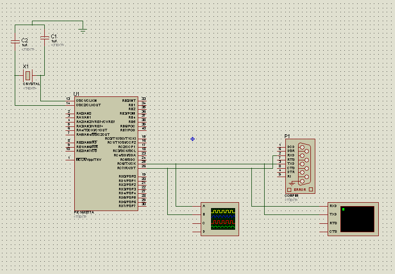

I am doing my final year project SCADA. When i run the simulation this error occurs.
pic or eeprom data has invalid address[2000] for this device.
How to remove this error?
The EEPROM is located from 2100h-21FFh
You only need to know this if you are going to initialise the EEPROM in your source code, in which case you need an ORG 2100h before the DE statements.
When accessing the EEPROM in your code, this address is irrelevant, because you only specify an 8 bit offset into the EEPROM.
Also, why are your Crystal caps 1uF? Shouldn't they be in the lower pF range?
You need to post the code.... You are accessing eeprom data outside the limit of the device selected
Here's the code which display the values on LCD and sends them through GSM. There might be some error that maybe causing the simulation error. Can you figure it out?
How to change the 0ffset?
Does it affect the frequency? Should I change the capacitor ratings to pF?
For simulation, the osc circuit isn't needed...
In mikroC have you got the pic16f877a as the device.... As your code is okay.... If ISIS complains about invalid address it can only be two things...
Either your device is the wrong one or the code is being generated incorrectly... Check your settings in mikroC...
