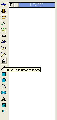

have you noticed the virtual instrument selection button on the left hand side?
The icon looks like an analog voltmeter.

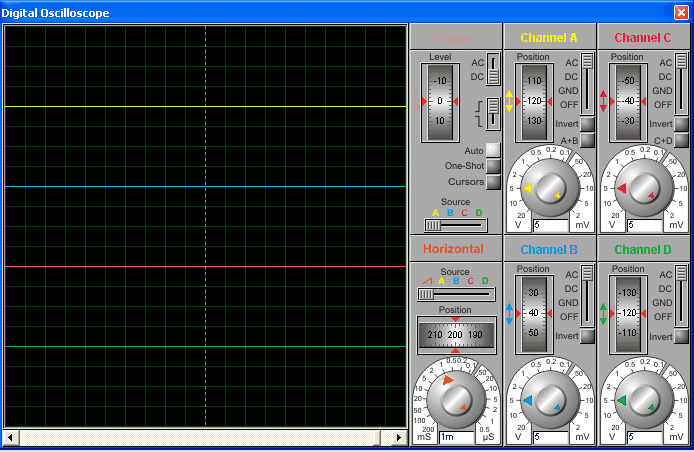

You might use the digital scope (4 channel) to see what's going on in the circuit.
If you kick off the scope during simulation you can get it back when using "Debug" and select digital scope.

A timer won't show you the voltage slope of a slowly charging cap.
An oscilloscope does it. You can read (and adjust) the time setting from 500ns to 200ms per horizontal division, and the input voltage from 2mV to 20 per vertical division.
Calculate frequency using f(Hz)=1/t(sec)
If you want to have the frequency >1Hz displayed using the counter change the properties to indicate frequency. The freqency counter displays frequencies only as integer values. So you don't know if the frequency is 50 or 51Hz. With a scope and the proper setting you can!

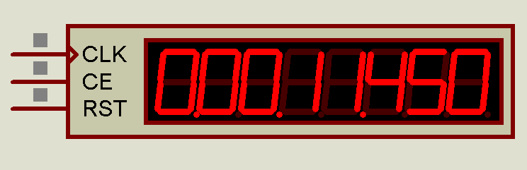

Right click on the counter and select "EDIT".
a pupup window will show you the setting. Change to hr.min.sec. and you'll get the timer displayed like this. The example shows an elapsed time of 11 seconds and 450/1000 seconds.
